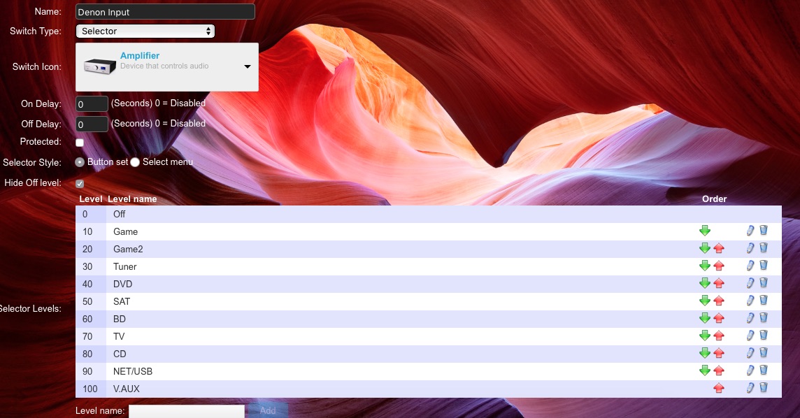

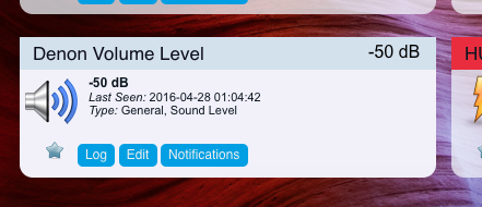

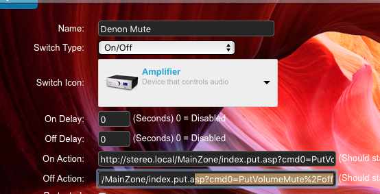

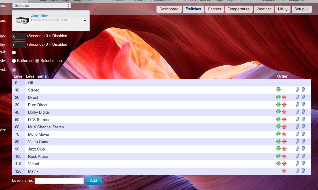

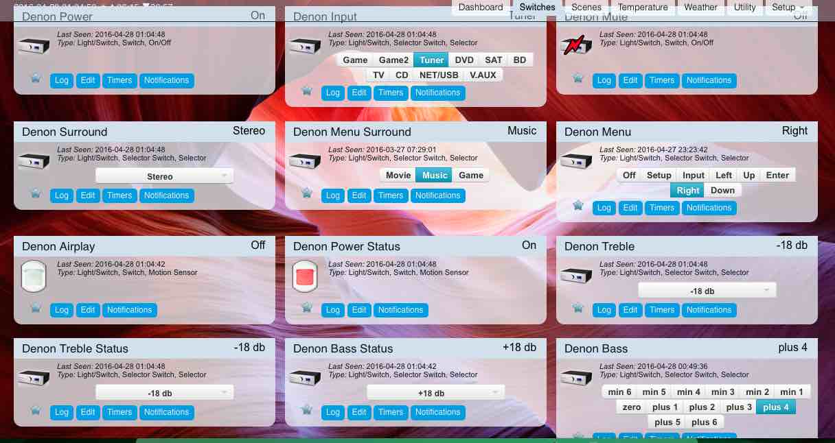

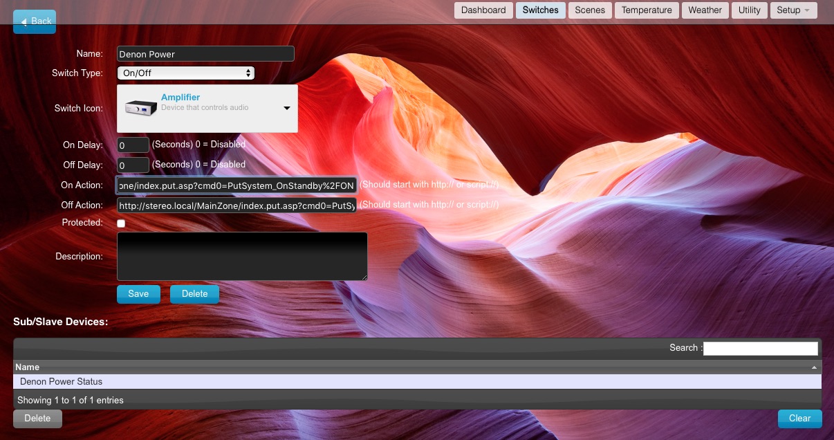

trixwood
Re: Denon AV Reciver - plugin
Post by trixwood »
Denon
TRiXWooD Scripts viewtopic.php?f=23&t=12145&p=87422#p87422
I have these scripts running with a lot of virtual devices for denon av1912. It will also run for any other denon, marantz if you change some value's. It's fun in progress. Almost had the bass/treble working. But a selector switch with more then 10 buttons does not work in Version: 3.4978 of domoticz.
still... have phun...
Update Changed it so it only updated values when changed... v0.2a
Update Fixed AirPlay & Mute bug v0.2b
Update v3 of script with volume Control can be found here http://domoticz.com/forum/viewtopic.php ... 421#p85421
Update example xml files from av1912 for comparison http://domoticz.com/forum/viewtopic.php ... =60#p91937, and domotixs had selector switches support!!! (thanks!)

Ok, now the basics... we want to get some value's like volume, source input, power status, airplay and we want some control, like source select, mute, standby, individual speaker volume control, the works. Preferably without telnet, due to the one connection restriction. So our first try ended up like this (bass/treble work in progress):
then my main script is
denon.sh

You have to configure the virtual devices, change the ip addresses and port to the correct ones and set the correct id's before running, also the AVsurround variable can contain different text if you do not have an 1912 model. Just get the correct value's by entering this address in your browser (replace the ip 10.0.0.91 with the ip of your denon stereo) http://10.0.0.91/goform/formMainZone_MainZoneXml.xml
Note that the script does not care if your denon is setup with relative or absolute volume (-80db .. 18db, or 0 ..100)
For the input selector and the power on/off switch you need two virtual devices. A status one which receives the status from the script and another selector set up like this:
Use ON or OFF with capitals, I know one is not showing, you make more screenshot ;-) Why? because with one virtual switch the denon keeps switching on/off/on/off.... Sub/Slave Devices solves it! The virtual devices are just clones of each other, with the status one receiving the status from the script and due to the slave position it update the Denon Power switch, but NOT trigger its On/Off Actions. The scripts runs every 10 seconds using cron or launchcontrol. On OSX install the following launchagent in /Library/LaunchAgents or ~/Library/LaunchAgents. Change the domoticz installed folder to your own folder instead of /Users/Trixwood/Smarthome/. For OSX use http://www.soma-zone.com/LaunchControl
