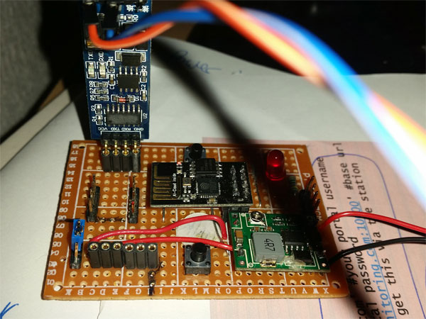

Here's a picture of the circuit I made.
An ESP-Programmer/breakout that I use.
ESP-8266-01, RS485, Power Dropper, Reset and Program buttons
