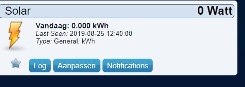

Hi, Found this post as I want to display my SAJ info in Domoticz too, but I need a some help please.
So far:
Took the script from the 3th post in this thread and added the IP address of my SAJ.
placed the script in "/home/pi/domoticz/scripts/lua" annd named is: "Solar.lua"
Created virtual hardware and 2 virtual devices. And didn't do anything with properties of them.
Rebooted my Pi. But sofar... nothing happens. Last update time in the devices is from the time I installed them.
So no values are read.
Do I need to do something with IDX?
In the logs, I don't find anything, or maybe thats because my Pi smartmeter is generating a lot of logs.
I see this: PluginSystem: Failed dynamic library load, install the latest libpython3.x library that is available for your platform.
But maybe that is not the issue.
Anyone a hint?
Edit, could someone post the script with the ping option?

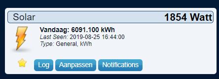

Ok, took some reading and now the info is read every minute with LUA from my invertor.
Filename had to be script_time_solar.lua RTFM.....
But it seems the values are not displayed correctly. Today (vandaag) shows the valuw for Total.
So I miss the values like in your examples, today and total displayed together.
