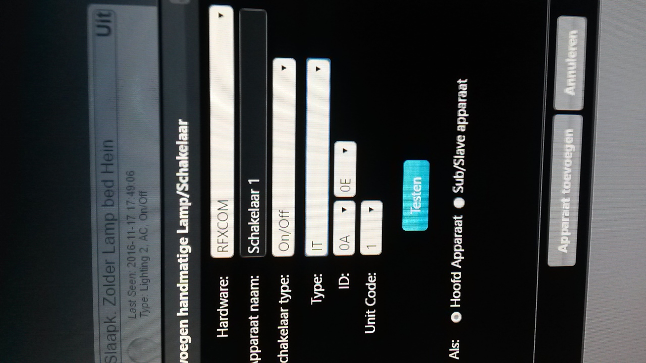

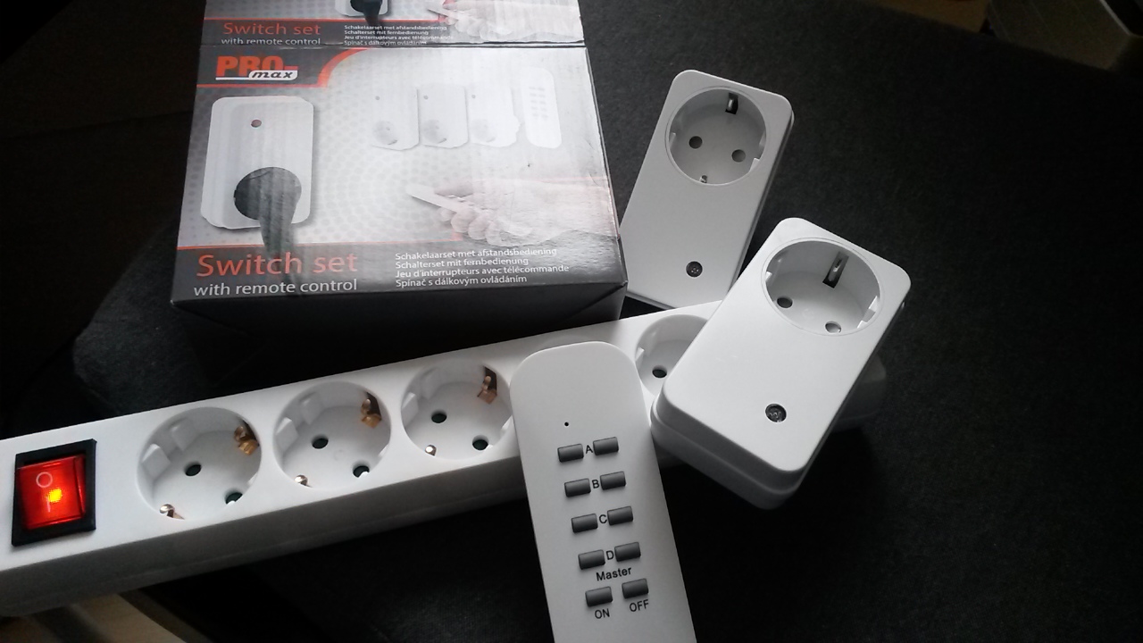

Re: Action Promax
Just bought a set at the Action. But what I try, it won't work.
Raspberry Pi with RFXcom433e. IT-protocol present
Domoticz v3.4834
How to solve this?
When I push the test-button. It sends the signal, but the switch won't go on, keeps blinking
Learning with the remote that comes with the set, does work.
Domoticz v3.4834
How to solve this?

b_weijenberg
- Posts: 524
- Joined: Friday 12 July 2013 18:13
- Target OS: -
Re: Action Promax
IT transmit is supported in Ext2 firmware. You have Ext2 firmware in the RFXtrx433E?
Disconnect the module from the power,
Wait 5 seconds,
Connect the module to the power,
The LED on the module should blink now and transmit an ON command.
Wait 5 seconds,
