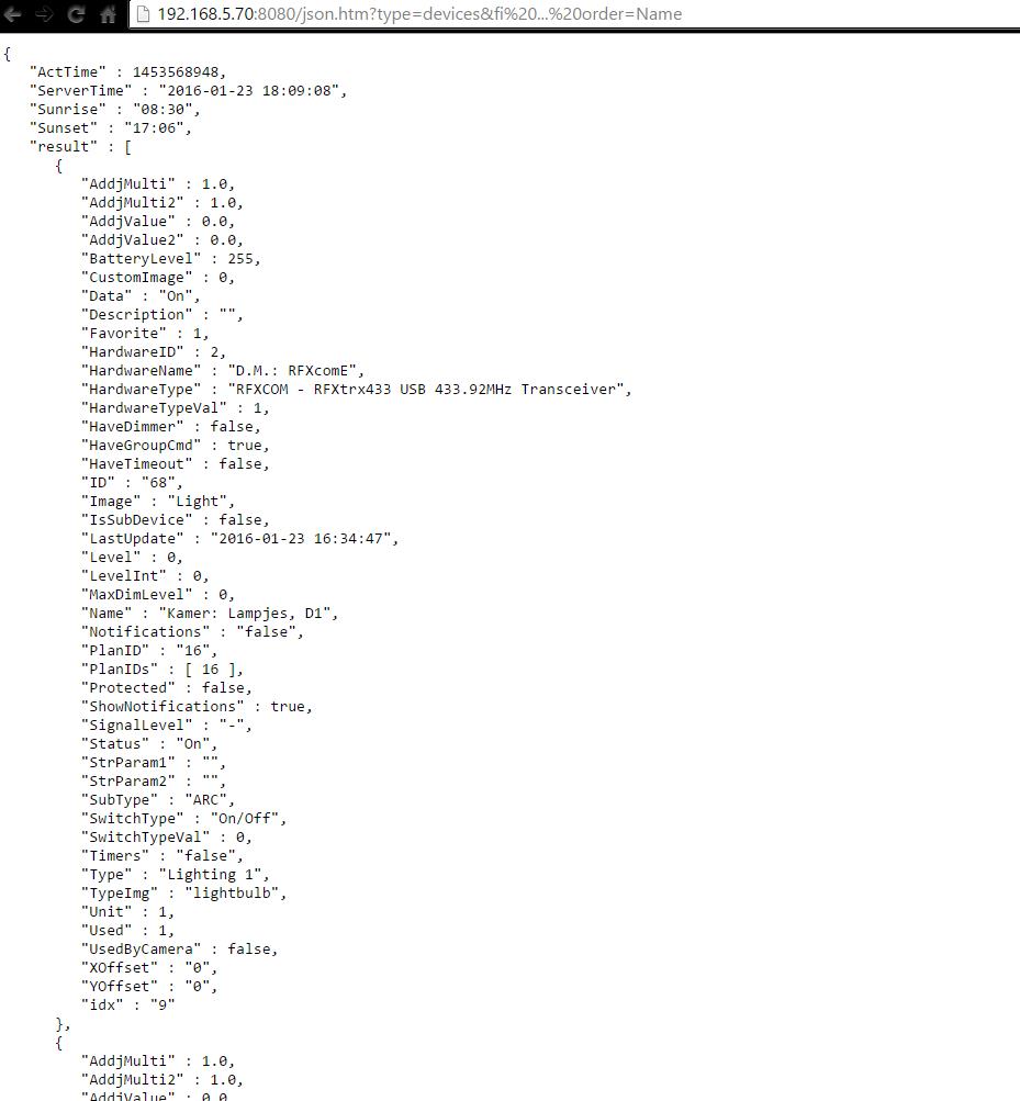

And i try this:
And there is see my switches...
Where do i go wrong?

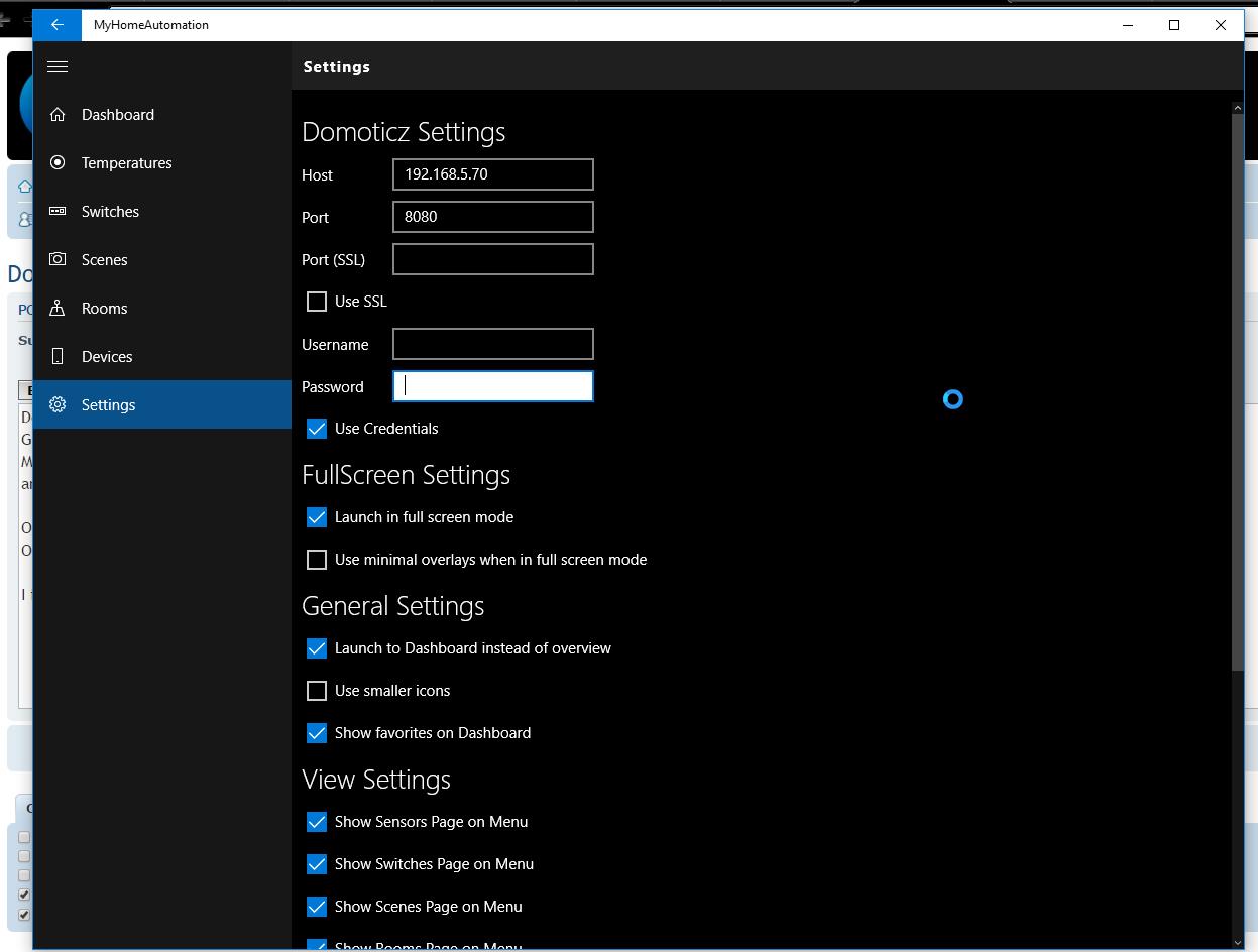

Re: Domoticz App for Windows 10 UWP
Posted: Saturday 23 January 2016 18:23
by Sneezydevil
I see U have "Use Credentials" and Username and Password are empty. Did you empty the Username and Password so we can't see? If not try unchecking that box.

by Derik
When i am in my lan i do not need user and pass. I set in domoticz..
Crydentials i try on and off

Since Domoticz starts SSL by default aswell, what happens when you check the "Use SSL" Checkbox?

Derik wrote:When i am in my lan i do not need user and pass. I set in domoticz..
I see cortana is not supported in my language (dutch) perhaps that is a problem?
The language should not make a difference, I run the app on a Dutch laptop aswell and that works fine. Cortana will not work when a laptop is set to Dutch that is correct. If anything it should work faster on a Dutch laptop since it does not have to load the Cortana Speech files.
So when you are in your LAN, make sure the checkbox "Use Credentials" is empty and then press "Load Devices" on the Devices Page.
I will have to figure out a way to autodetect if credentials are needed or not.
Posted: Saturday 23 January 2016 22:00
by Sneezydevil
I think hue will work by monday (not the colors yet though).
You remember the URL je opened before with the JSON? Find one of your zwave items and let me know what type says:
For hue it says:
"Type" : "Lighting Limitless/Applamp",
Thanks in advance!
