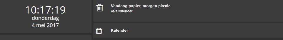

SwordFish
Posts: 278
Domoticz version: V4.11375
Re: Dashticz v2.0, custom positioning and multiple screens
Post by SwordFish »
pvdhelm wrote:my garbage bin script isn't working correct. Everyday of the week he tells me to put the garbage outsite, this must be on mondays. and when the collect day is of GFT and Plastic he only display one item

I had the same problem with today paper and tomorrow plastic. I did combine the in to one see my script
week    = tonumber (os.date( "%V"))
dag      = tostring(os.date("%a"));
status   = tonumber(otherdevices_svalues['Afval'])
print('script bin_selector executed')
print ('Dag=  '..dag)
if (dag=='Sat' or dag=='Sun'  ) then
   weekend = true; weekdag = false
if (dag=='Mon' or dag=='Tue' or dag=='Wed' or dag=='Thu' or dag=='Fri') then
   weekend = false ; weekdag = true
--Bepalen morgen papier
if(week==2 and dag=='Wed' or week==4 and dag=='Wed' or week==6 and dag=='Wed' or week==8 and dag=='Wed' or week==10 and dag=='Wed' or week==12 and dag=='Wed' or week==14 and dag=='Wed' or week==16 and dag=='Wed' or week==18 and dag=='Wed' or week==20 and dag=='Wed' or week==22 and dag=='Wed' or week==24 and dag=='Wed' or week==26 and dag=='Wed' or week==28 and dag=='Wed'
	or week==30 and dag=='Wed' or week==32 and dag=='Wed' or week==34 and dag=='Wed' or week==36 and dag=='Wed' or week==38 and dag=='Wed' or week==40 and dag=='Wed' or week==42 and dag=='Wed' or week==44 and dag=='Wed' or week==46 and dag=='Wed' or week==48 and dag=='Wed' or week==50 and dag=='Wed' or week==52 and dag=='Wed') then
      morgenpapier = true; papier = false; plastic = false; niets = false
print ('morgen papier')
--Bepalen papier
if(week==2 and dag=='Thu' or week==4 and dag=='Thu' or week==6 and dag=='Thu' or week==8 and dag=='Thu' or week==10 and dag=='Thu' or week==12 and dag=='Thu' or week==14 and dag=='Thu' or week==16 and dag=='Thu' or week==18 and dag=='Thu' or week==20 and dag=='Thu' or week==22 and dag=='Thu' or week==24 and dag=='Thu' or week==26 and dag=='Thu' or week==28 and dag=='Thu'
	or week==30 and dag=='Thu' or week==32 and dag=='Thu' or week==34 and dag=='Thu' or week==36 and dag=='Thu' or week==38 and dag=='Thu' or week==40 and dag=='Thu' or week==42 and dag=='Thu' or week==44 and dag=='Thu' or week==46 and dag=='Thu' or week==48 and dag=='Thu' or week==50 and dag=='Thu' or week==52 and dag=='Thu') then
      morgenpapier = false; papier = true; plastic = false; niets = false
print ('vandaag papier morgen plastic')
--Bepalen plastic
if(week==2 and dag=='Fri' or week==4 and dag=='Fri' or week==6 and dag=='Fri' or week==8 and dag=='Fri' or week==10 and dag=='Fri' or week==12 and dag=='Fri' or week==14 and dag=='Fri' or week==16 and dag=='Fri' or week==18 and dag=='Fri' or week==20 and dag=='Fri' or week==22 and dag=='Fri' or week==24 and dag=='Fri' or week==26 and dag=='Fri' or week==28 and dag=='Fri'
	or week==30 and dag=='Fri' or week==32 and dag=='Fri' or week==34 and dag=='Fri' or week==36 and dag=='Fri' or week==38 and dag=='Fri' or week==40 and dag=='Fri' or week==42 and dag=='Fri' or week==44 and dag=='Fri' or week==46 and dag=='Fri' or week==48 and dag=='Fri' or week==50 and dag=='Fri' or week==52 and dag=='Fri') then
      morgenpapier = false; papier = false; plastic = true; niets = false
print ('vandaag plastic')
--Bepalen geen plastic en geen papier
if(dag=='Mon' or dag=='Tue' or dag=='Sat' or dag=='Sun') then
      morgenpapier = false; papier = false; plastic = false; niets = true
print ('vandaag geen afval buiten zetten')
if (niets and dag) then
      commandArray ['UpdateDevice']= '316|1|Geen ophaaldag'
if (morgenpapier and weekdag and dag) then
      commandArray ['UpdateDevice']= '316|1|Morgen papier'
if (papier and weekdag and dag) then
      commandArray ['UpdateDevice']= '316|1|Vandaag papier, morgen plastic'
if (plastic and weekdag and dag) then
      commandArray ['UpdateDevice']= '316|1|Vandaag plastic'
return commandArray
SwordFish
Posts: 278
Post by SwordFish »

robgeerts
Posts: 1273
Domoticz version: 3.7067
Post by robgeerts »
Thats because the scripts set every other container to false when one is set to true ;)
Basically like:
if(week=12){
 groen=true;
 grijs=false;
 oranje=false;
if(week=13){
 groen=false;
 grijs=true;
 oranje=false;
When you actually need:
groen=false;
grijs=false;
oranje=false;
if(week=12){
grijs=true
if(week=12){
groen=true
I know, this is not valid coding ;)
