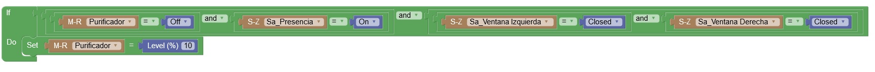

hello!,
In xiaomi mihome app there is a easy scene that i want to replicate in domoticz.
Now i can create a scene with blocky that turn purifier on when detect movement in the sensor but i cant make this other scene:
"when move detector not detect move in 30 minutes, then purifier off"
Anyone can help me?. I tried with blocky but i cant :-(
thanks

DAVIZINHO wrote: Wednesday 20 September 2017 19:20 hello!,
thanks
-David-
Show what you got in Blocky

pandemicz wrote: Wednesday 20 September 2017 20:29
thanks
-David-
i use this blocky to turn on the purifier.
But i want to create a blocky to turn OFF the purifier when not detect movement in "movement sensor" in 30 minutes :-(
thanks
-David-
Use LUA that the only way to do your script

deennoo wrote: Thursday 21 September 2017 21:35
ok, thanks for the info.
Can you tell me how can i make this on lua?.
I only need help for the "if" comand because i dont know how to program the "if sensor not detect move in 30min then"

Post by Egregius »
With pass2php:
if(timestamp('motion')<time-1800&&status('motion')=='Off'&&status('purifier')=='On')sw('purifier','Off');
Can it be more simple?
Let's see how much code you'll need in lua to do the same...
