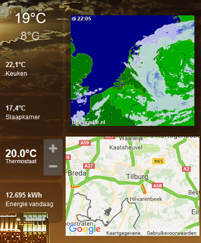

Is there a way to put the traffic map also in the same borders as the rest of the buttons (with the darker background and round corners)?
Now it looks a bit off...

by robgeerts
lukev wrote:Is there a way to put the traffic map also in the same borders as the rest of the buttons (with the darker background and round corners)?
Try latest beta!
