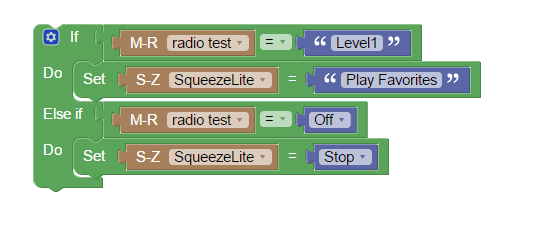

Is it possible to use the selector switch with blockly to play favorites, playlists, volume etc?
I have a selector switch, and in blockly i can stop my squeeselite player with the off button, but when i try to play favorites with the level1 button nothing happens.
- block.png (16.2 KiB) Viewed 28555 times
