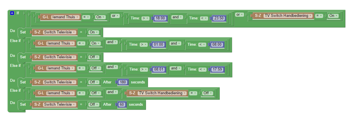

I have a question. I have the following blockly event made for turning off my tv, mediabox and Horizon.
The problem is the following; when away is set on, it will take 5 minuten before it turns off. But when Home is set within the 5 minutes, the media will turn off anyway. It looks like the event is not canceled. Is it something in my blockly event of is it perhaps a "bug"?
pj-r
Posts: 140
Joined: Wednesday 17 December 2014 17:30
Domoticz version: V3.8650
Location: Jyväskylä, Finland
Re: Blockly examples
Post by pj-r »
How do you think domoticz knows to cancel the timer you have set at "set off after..."? ;)
You need to "build" your own timer. So add "AwayTimer" variable or virtual switch to use as a flag.
Then just add bit more cases there(Havent tested but it should work this way):
If Away = On and AwayTimer = Off and Media = On <-- case when you leave the house
 set AwayTimer = On After 5 minutes
Else if Away = On and AwayTimer = On and Media = On <-- case when timer time has passed and you are still away
 set AwayTimer = Off
 set Media = Off
Else if Away = Off and AwayTimer = On <-- case where you cancel the timer eg. return home within 5 minutes
 set AwayTimer = Off
 set Media = On <-- not sure if needed here
Else if Away = Off <-- case when you return to home
 set Media = On
Perhaps some "cancel timers of device xxx" block could help to make these more simple looking.

dressie wrote:I have a question. I have the following blockly event made for turning off my tv, mediabox and Horizon.
I've done the same here..
Maybe you can learn from this blocky?
G'Luck.
Note, the time function to stay ON between 18.00 and 23.50 is for recording programs @ the horizon box :-)

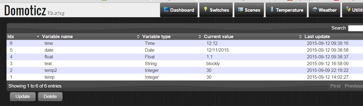

Yury
Joined: Sunday 13 September 2015 16:07
Post by Yury »
Please Help.
I do not understand variables comparison. Whenever I use user variables like Time, Integer or String in IF statement it does not work.
This event supposed to occur every minute. but not.

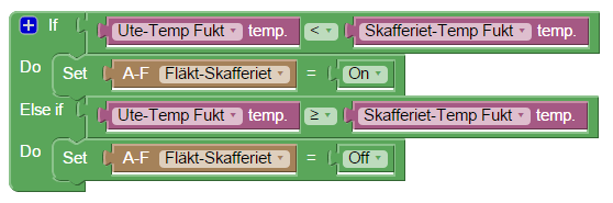

Post by Docc »
Can someone please help me understand why this is not working..? :-S
It is a simple fan control. Fan should go on if outside temp is lower than inside temp and goes off if not, but the fan stays off :-(

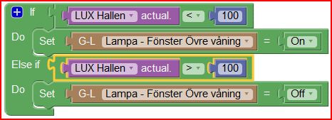

À short question.
Is it possible to use LUX as a comparing in Blocky?
Trying to determine if lights should be on or off based on lux.

@Minglarn, Yes you can use:-
If Lux < x
Do set Switch On
This works:-

Posts: 890
Post by ThinkPad »
But be sure to have some margin.
<150 lux = On
> 200 lux = Off
Otherwise (with the on/off comparison value close to eachother) your lights might go acting very nervous if a cloud flies by, switching your lights on, and off very soon after.

Post by Minglarn »
Cant get this to work. The actual value for "LUX Hallen" is 67.
But no reaction to this blocky..
Using: v2.311..
As the abowe did not work I tryed a dummy swich and now it works...
Using this blocky:

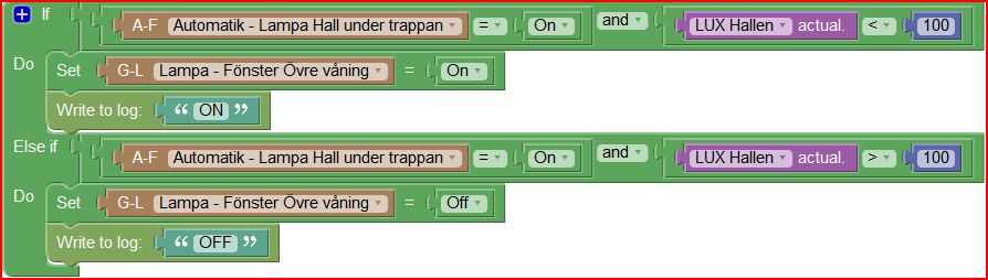

Post by Minglarn »
OKey need some help here...
I Want this blocky to be active ony between time from morgning 06:00 and after midnight 00:30 . How do I make the time comparison?
Would this work?
