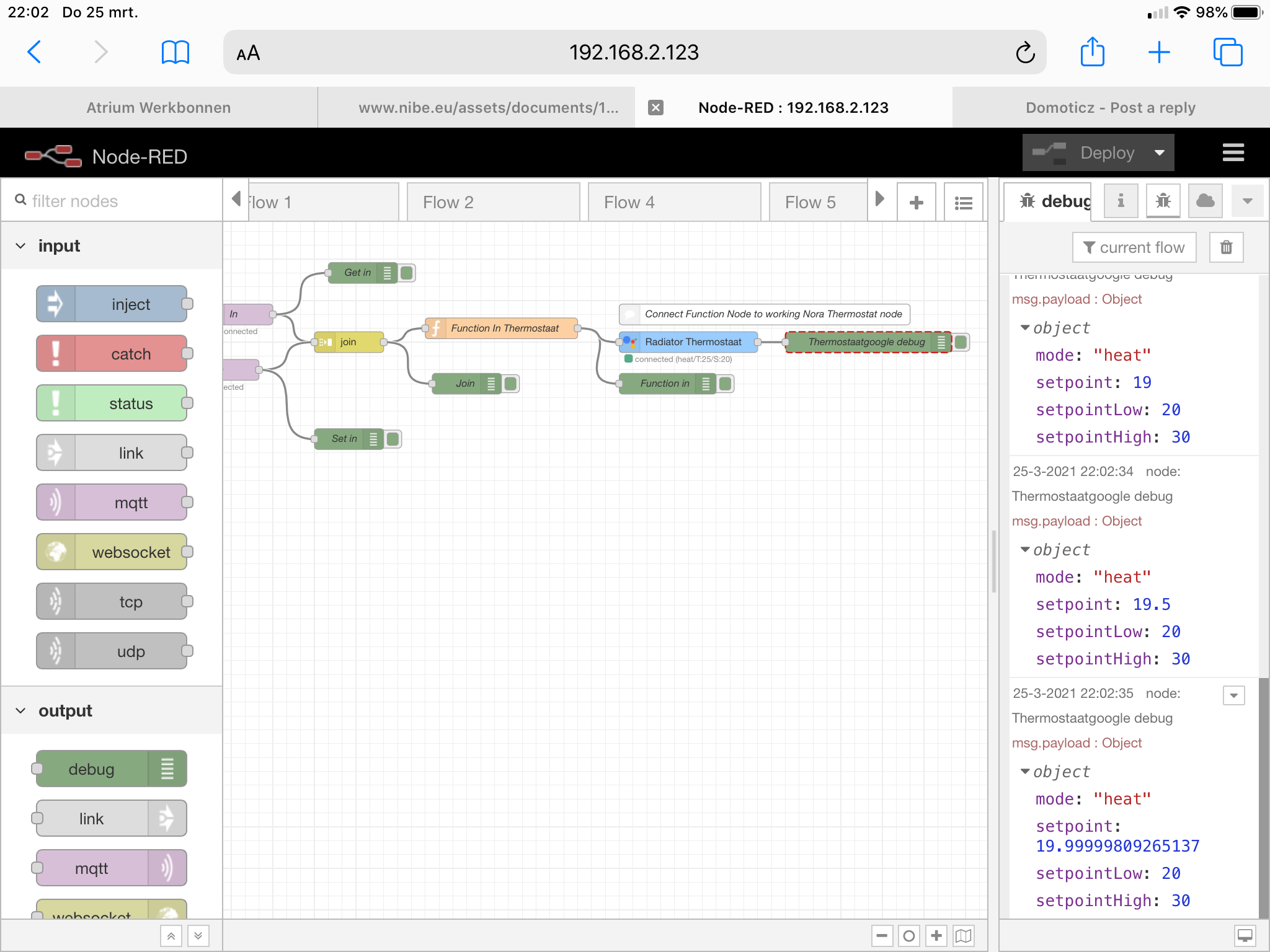

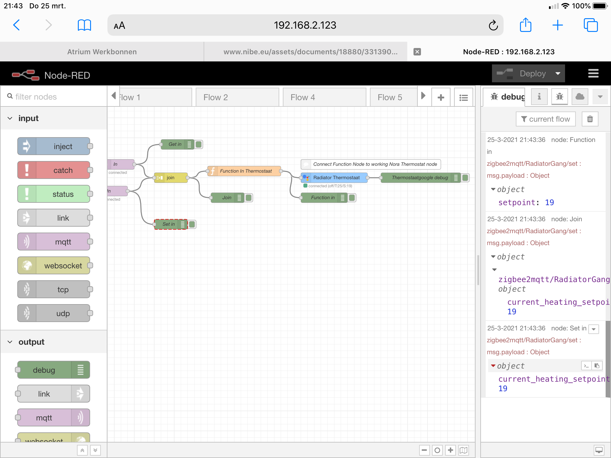

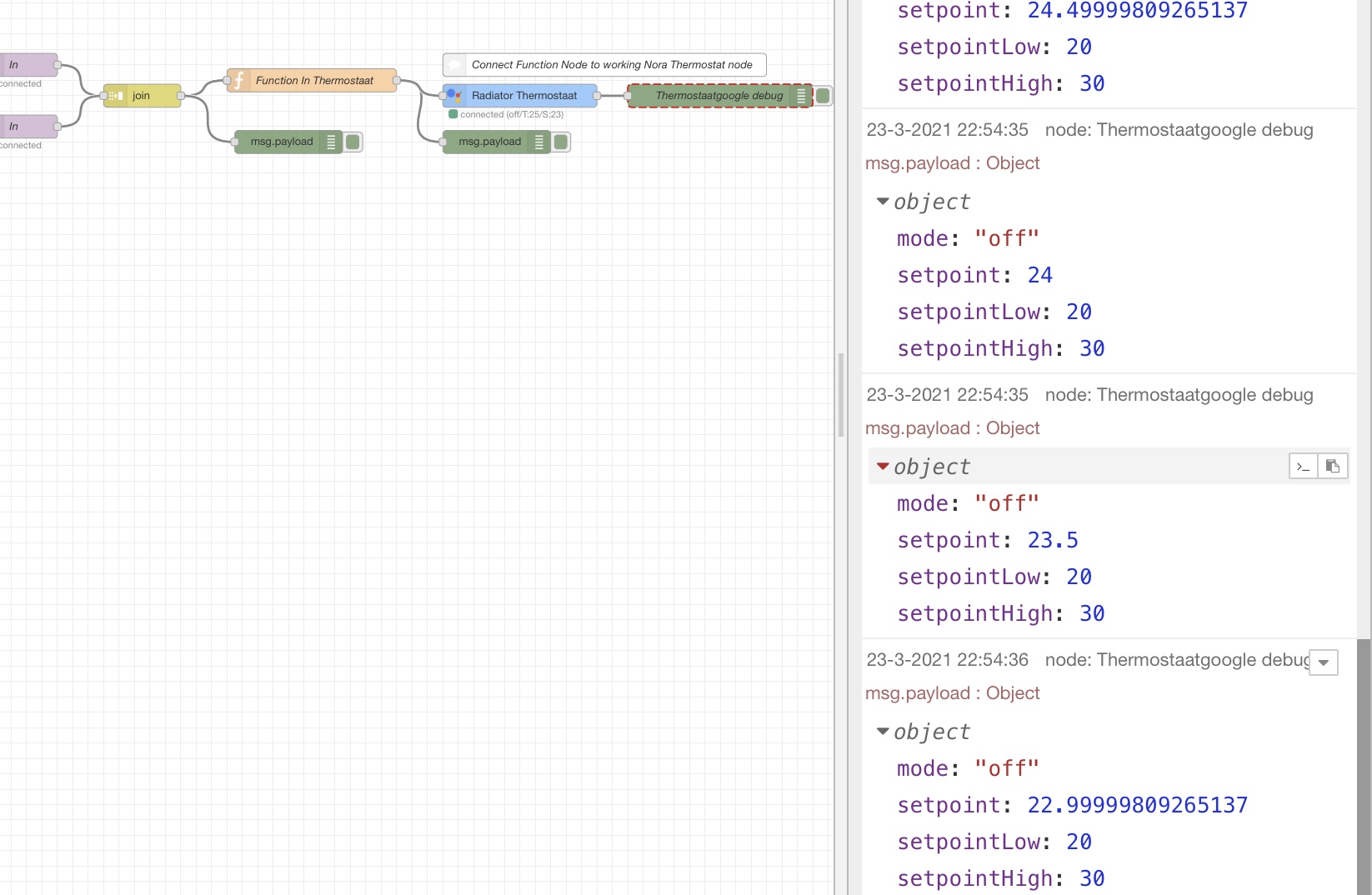

Hello @edwin1234
So lets repeat, so that I'm sure that I understand.
1. From Domoticz to Google Home (Nora Thermostat node): Not Functioning.
2. From Domoticz to Thermostat works
3. From Thermostat to Google Home (Nora Thermostat node): Not Functioning.
4. From Thermostat to Domoticz works
5. From Google Home to Domoticz and/or Thermostat: Not Functioning.
The local temperature in node red stays on 25 degrees, but the set temperature charges like it should.
What do you mean? Sorry, I do not understand.
Where i try to turn on googlehome thermostat i get this:
Bu the thermostat in Google Home stays of.Image
Sorry, I have no idea what you mean.
I look to the picture, but I have no idea what I see.
Can you click on the arrows, if you send something, so that the tree opens and I can see more information.
It is also important that one can see, which message comes from which node.
As an example, the first message, where does it comes from?
I need really more clear information, before I can give support.

Point 1 to 5 are true.
The image i send is the output from node red when i open the google home thermostat.look at the message payload object
In the radiator thermostaat node in node red the local temperature stays on 25 degrees dont no why its 25 degrees, but the setpoint does change when i set it in domoticz or on the thermostat valve.
The google home thermostat doesnt change.
When i click on the inject node u made in your first post then the local temperature
Change to the right local temperature on the node red radiator thermostaat but after a while the local temperature changes back to 25 degrees ?
