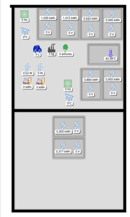

I got installed my solar panels today with a ECU-C, and I followed your instructions and it is working as a charm.
Thank you for sharing your configuration.

Yesterday my Ecu-C was updated from version 1.1.9 to 1.2.0, and it has become a bit crazy with the values, I think we must review node-red. They must have added DC Volt in the html table.
