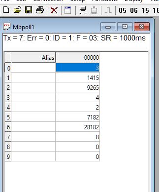

Re: [RELEASED] Python plugin: Modbus RTU / ASCII / TCP/IP
Try to verify if modbus on the device side is set correcty using PC (eg. Modbus Poll). Once you know it's ok then you can troubleshoot the python.

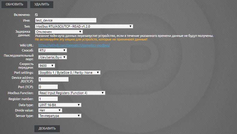

Im trying modbus first time. I use domoticz v4.11024@Python 3.5.3
I just upload an example to my arduino and try to read something trough modbus RTU
Unfortunately I always get the error that ot depend of payload or register number.
On the other side I can read data with modbus poll simulator
What am I doing wrong? Thx.
PS there is no any information what should be a payload for common purpose in domoticz (sensors, buttons etc).

- 3.JPG (29.92 KiB) Viewed 4933 times
- 2.JPG (34.46 KiB) Viewed 4933 times
- 1.JPG (60.54 KiB) Viewed 4933 times

- Posts: 8
- Joined: Sunday 01 April 2018 17:30
Every functions gives same error
I even tried to use discrete output slave, but error still the same
Have nothing here
Have nothing here
- Снимок.PNG (32.96 KiB) Viewed 4912 times
