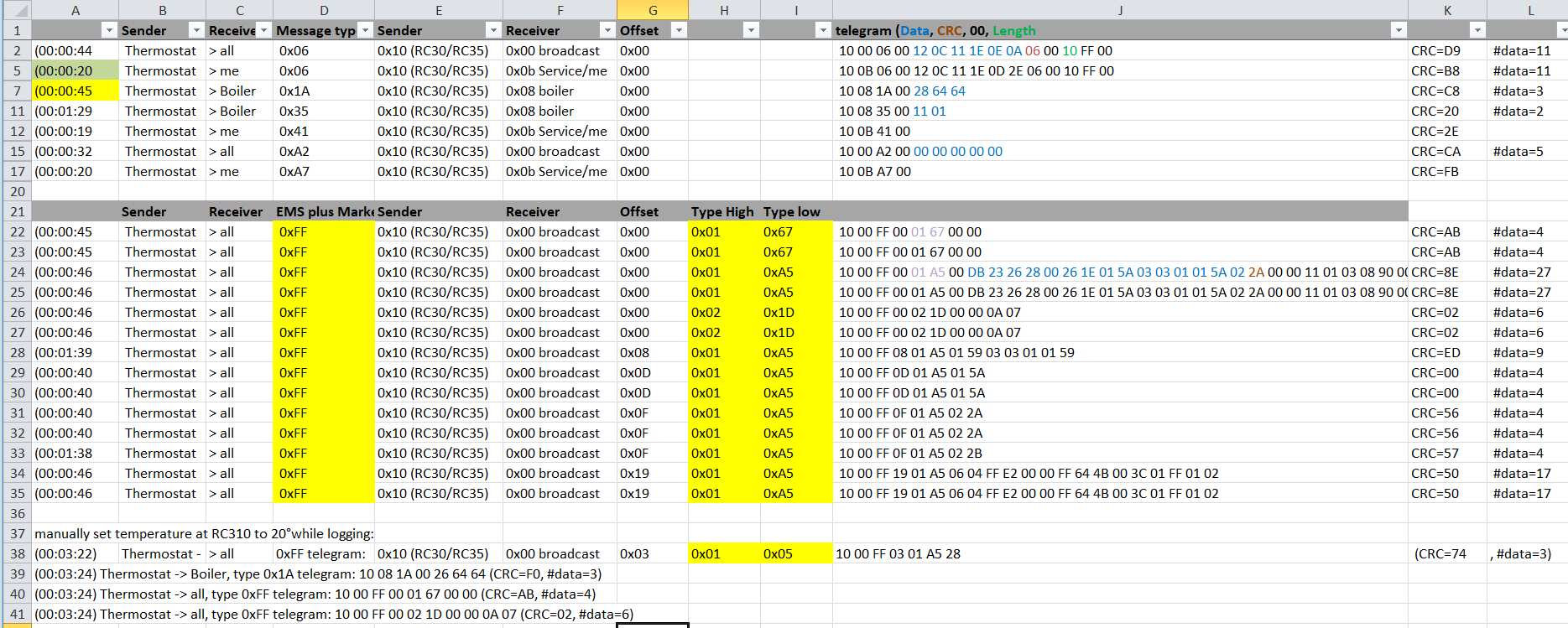

My main working point are thermostat messages. Below a log picture, where I seperated telegram types which have 0xFF .
For those I applied the EMS+ ( EMS plus ?) rules as described in EMS wiki https://emswiki.thefischer.net/doku.php ... telegramme.
The EMS+ 2 Byte telegram types are unfortunately not documented yet. Since same telegram types are shown with different data length, I assume the principle EMS+ telegram interpretation is still wrong.
Added: I noticed that EMS+ telgrams with same type and different data length have different offset (19 and 0D in the example below).
10 00 FF 19 01 A5 01 04 FF EB 00 00 FF 64 4B 00 3C 01 FF 01 02 (CRC=EC, #data=17)
10 00 FF 0D 01 A5 01 20 (CRC=7A, #data=4)

Thermostat related logs below: - you can see types with 0xFF.
Example:
(00:00:45) Thermostat -> all, type 0xFF telegram: 10 00 FF 00 01 67 00 00 (CRC=AB, #data=4)
according https://emswiki.thefischer.net/doku.php ... telegramme for EMS+:
Sender : 0x10 // RC35 (my RC310) assumed
Receiver 0x00 // all
type : EMS+ Marker: 0xFF
Offset : 0x00
type High Byte: 01
type Low Byte: 67
daty bytes
CRC
data length
(00:00:20) Thermostat -> me, type 0xA7 telegram: 10 0B A7 00 (CRC=FB)
(00:00:20) Thermostat -> me, type 0x06 telegram: 10 0B 06 00 12 0C 11 1E 0D 2E 06 00 10 FF 00 (CRC=B8, #data=11)
(00:00:32) Thermostat -> all, type 0xA2 telegram: 10 00 A2 00 00 00 00 00 00 (CRC=CA, #data=5)
(00:00:40) Thermostat -> all, type 0xFF telegram: 10 00 FF 0F 01 A5 02 2A (CRC=56, #data=4)
(00:00:40) Thermostat -> all, type 0xFF telegram: 10 00 FF 0D 01 A5 01 5A (CRC=00, #data=4)
(00:00:44) Thermostat -> all, type 0x06 telegram: 10 00 06 00 12 0C 11 1E 0E 0A 06 00 10 FF 00 (CRC=D9, #data=11)
(00:00:45) Thermostat -> Boiler, type 0x1A telegram: 10 08 1A 00 28 64 64 (CRC=C8, #data=3)
(00:00:46) Thermostat -> all, type 0xFF telegram: 10 00 FF 00 01 A5 00 DB 23 26 28 00 26 1E 01 5A 03 03 01 01 5A 02 2A 00 00 11 01 03 08 90 00 (CRC=8E, #data=27)
(00:00:46) Thermostat -> all, type 0xFF telegram: 10 00 FF 19 01 A5 06 04 FF E2 00 00 FF 64 4B 00 3C 01 FF 01 02 (CRC=50, #data=17)
(00:00:46) Thermostat -> all, type 0xFF telegram: 10 00 FF 00 02 1D 00 00 0A 07 (CRC=02, #data=6)
(00:00:56) Thermostat -> Boiler, type 0x23 telegram: 10 08 23 00 28 64 64 (CRC=73, #data=3)
(00:01:10) Thermostat -> me, type 0x41 telegram: 10 0B 41 00 (CRC=2E)
(00:01:10) Thermostat -> me, type 0xA7 telegram: 10 0B A7 00 (CRC=FB)
(00:01:29) Thermostat -> Boiler, type 0x35 telegram: 10 08 35 00 11 01 (CRC=20, #data=2)
(00:01:38) Thermostat -> all, type 0xFF telegram: 10 00 FF 0F 01 A5 02 2B (CRC=57, #data=4)
(00:01:39) Thermostat -> all, type 0xFF telegram: 10 00 FF 08 01 A5 01 59 03 03 01 01 59 (CRC=ED, #data=9)
(00:01:45) Thermostat -> all, type 0x06 telegram: 10 00 06 00 12 0C 11 1E 0F 0B 06 00 10 FF 00 (CRC=B9, #data=11)
(00:00:19) Thermostat -> me, type 0x41 telegram: 10 0B 41 00 (CRC=2E)
RC310 Thermostat Logs.PNG (132.09 KiB) Viewed 8822 times

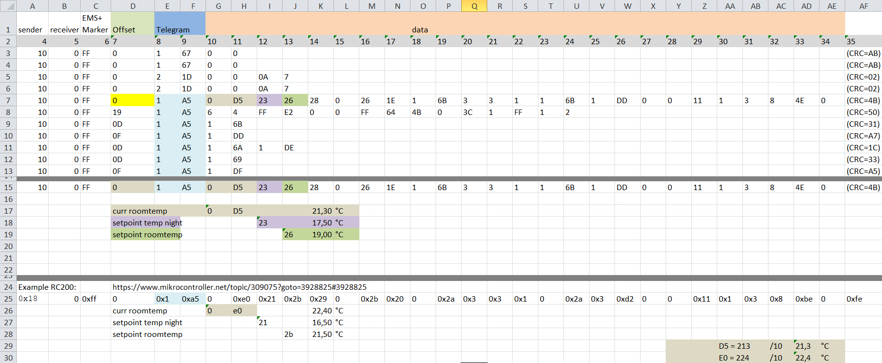

following the link mentioned in ems plus wiki "Gedankenstütze/Externer Link", https://emswiki.thefischer.net/doku.php ... telegramme, I found a hint in https://www.mikrocontroller.net/topic/3 ... 25#3928825 from
Autor: Frank S. (blaueslicht) Datum: 17.12.2014 23:48: for a RC200, which is also an EMS+ telegram.
Thanks to Frank S. for bringing me a step ahead!
I searched for a similar "pattern" in my RC310 telegram log and found EMS+ telegram type 0x01A5
RC310 Thermostat teltype 0x01A5.PNG (76.29 KiB) Viewed 8740 times
In the upper part are my telegrams, one is the 0x01A5 telegram, in the middle part an explanation of the 0x01A5 telgram interpretation and in the lower part the RC200 example from Frank S.
My interpretation is still in state "guesswork".
I do not understand why 0x01A5 telegrams have different data length, but whenever the yellow highlighted byte is 0x00, I get the data bytes which seem to match my temperature values.
So the meaning and use of the yellow highlighted Byte is unclear to me.
Since I do not want to change thermostat values for the moment, I'll monitor if my assumptions are correct:
proddy's MQTT Messages to a MOSQUITTO broker running on a Raspberry PI -> MQTT client forwards selected topic values to an rrd database -> rrd time series diagrams.
Any further help, confirmation or comment is welcome ;)

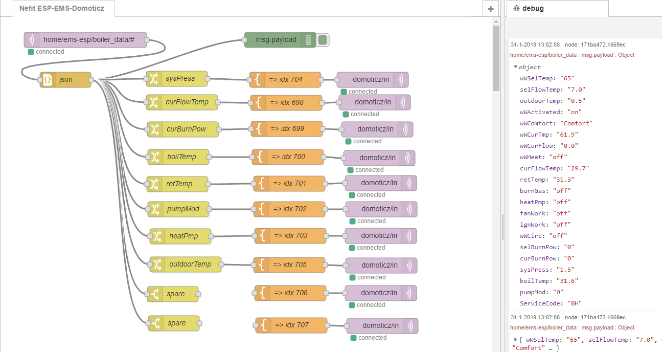

i've made an Node-Red example which is working for me,it isn't finished..
maybe someone can use it or have a better structure? anyhow feel free to modify and let me know your input :D
just copy to your clipboard and import in Node-Red, make dummy's in Domoticz and fill the idx the flow.
[{"id":"6bbbb18.55cde5","type":"tab","label":"Nefit ESP-EMS-Domoticz","disabled":false,"info":""},{"id":"ae5e5ebe.d561d","type":"mqtt in","z":"6bbbb18.55cde5","name":"","topic":"home/ems-esp/boiler_data/#","qos":"2","broker":"84c04735.540278","x":125,"y":20,"wires":[["c4a72dec.c542a"]]},{"id":"171ba472.1669ec","type":"debug","z":"6bbbb18.55cde5","name":"","active":true,"tosidebar":true,"console":false,"tostatus":false,"complete":"payload","x":506,"y":20,"wires":[]},{"id":"c4a72dec.c542a","type":"json","z":"6bbbb18.55cde5","name":"","property":"payload","action":"","pretty":false,"x":86,"y":98,"wires":[["171ba472.1669ec","ea326f3a.c08f4","db3d11f2.295bf","fe94ceab.2b7ea","42a64e97.ce9c9","c693eec0.6d2e5","ede21c10.5f766","6db5c7a0.4f1a08","85e6b231.8d4fa","fd309bda.867c68","36ea249d.41781c"]]},{"id":"4b90b832.0610b8","type":"mqtt out","z":"6bbbb18.55cde5","name":"","topic":"domoticz/in","qos":"","retain":"","broker":"84c04735.540278","x":691,"y":142,"wires":[]},{"id":"ea326f3a.c08f4","type":"change","z":"6bbbb18.55cde5","name":"curFlowTemp","rules":[{"t":"set","p":"payload","pt":"msg","to":"payload.curFlowTemp","tot":"msg"}],"action":"","property":"","from":"","to":"","reg":false,"x":314,"y":142,"wires":[["ac5d6148.d11ac"]]},{"id":"db3d11f2.295bf","type":"change","z":"6bbbb18.55cde5","name":"sysPress","rules":[{"t":"set","p":"payload","pt":"msg","to":"payload.sysPress","tot":"msg"}],"action":"","property":"","from":"","to":"","reg":false,"x":304,"y":96,"wires":[["a2effd65.e6728"]]},{"id":"ac5d6148.d11ac","type":"template","z":"6bbbb18.55cde5","name":"=> idx 698","field":"payload","fieldType":"msg","format":"handlebars","syntax":"mustache","template":"{\n\"idx\" : 698,\n\"nvalue\" : 0,\n\"svalue\" : \"{{payload}}\" \n}","output":"json","x":518,"y":143,"wires":[["4b90b832.0610b8"]]},{"id":"fe94ceab.2b7ea","type":"change","z":"6bbbb18.55cde5","name":"curBurnPow","rules":[{"t":"set","p":"payload","pt":"msg","to":"payload.curBurnPow","tot":"msg"}],"action":"","property":"","from":"","to":"","reg":false,"x":316,"y":195,"wires":[["3ee74a86.656126"]]},{"id":"3ee74a86.656126","type":"template","z":"6bbbb18.55cde5","name":"=> idx 699","field":"payload","fieldType":"msg","format":"handlebars","syntax":"mustache","template":"{\n\"idx\" : 699,\n\"nvalue\" : 0,\n\"svalue\" : \"{{payload}}\" \n}","output":"str","x":519,"y":194,"wires":[["6ca6014.7dc9f"]]},{"id":"6ca6014.7dc9f","type":"mqtt out","z":"6bbbb18.55cde5","name":"","topic":"domoticz/in","qos":"","retain":"","broker":"84c04735.540278","x":696,"y":195,"wires":[]},{"id":"8b69363e.0dc028","type":"mqtt out","z":"6bbbb18.55cde5","name":"","topic":"domoticz/in","qos":"","retain":"","broker":"84c04735.540278","x":700,"y":251,"wires":[]},{"id":"42a64e97.ce9c9","type":"change","z":"6bbbb18.55cde5","name":"boilTemp","rules":[{"t":"set","p":"payload","pt":"msg","to":"payload.boilTemp","tot":"msg"}],"action":"","property":"","from":"","to":"","reg":false,"x":307,"y":249,"wires":[["dfd57f4e.7357e"]]},{"id":"dfd57f4e.7357e","type":"template","z":"6bbbb18.55cde5","name":"=> idx 700","field":"payload","fieldType":"msg","format":"handlebars","syntax":"mustache","template":"{\n\"idx\" : 700,\n\"nvalue\" : 0,\n\"svalue\" : \"{{payload}}\" \n}","output":"str","x":521,"y":249,"wires":[["8b69363e.0dc028"]]},{"id":"c693eec0.6d2e5","type":"change","z":"6bbbb18.55cde5","name":"retTemp","rules":[{"t":"set","p":"payload","pt":"msg","to":"payload.retTemp","tot":"msg"}],"action":"","property":"","from":"","to":"","reg":false,"x":305,"y":302,"wires":[["94e4f746.fc1228"]]},{"id":"94e4f746.fc1228","type":"template","z":"6bbbb18.55cde5","name":"=> idx 701","field":"payload","fieldType":"msg","format":"handlebars","syntax":"mustache","template":"{\n\"idx\" : 701,\n\"nvalue\" : 0,\n\"svalue\" : \"{{payload}}\" \n}","output":"str","x":524,"y":301,"wires":[["d69bd943.24a368"]]},{"id":"d69bd943.24a368","type":"mqtt out","z":"6bbbb18.55cde5","name":"","topic":"domoticz/in","qos":"","retain":"","broker":"84c04735.540278","x":703,"y":300,"wires":[]},{"id":"f8cbaab7.cf8ee8","type":"template","z":"6bbbb18.55cde5","name":"=> idx 702","field":"payload","fieldType":"msg","format":"handlebars","syntax":"mustache","template":"{\n\"idx\" : 702,\n\"nvalue\" : 0,\n\"svalue\" : \"{{payload}}\" \n}","output":"str","x":524,"y":351,"wires":[["55b4f2d9.0cc7ec"]]},{"id":"ede21c10.5f766","type":"change","z":"6bbbb18.55cde5","name":"pumpMod","rules":[{"t":"set","p":"payload","pt":"msg","to":"payload.pumpMod","tot":"msg"}],"action":"","property":"","from":"","to":"","reg":false,"x":307,"y":351,"wires":[["f8cbaab7.cf8ee8"]]},{"id":"55b4f2d9.0cc7ec","type":"mqtt out","z":"6bbbb18.55cde5","name":"","topic":"domoticz/in","qos":"","retain":"","broker":"84c04735.540278","x":704,"y":351,"wires":[]},{"id":"adaeedaf.eb763","type":"mqtt out","z":"6bbbb18.55cde5","name":"","topic":"domoticz/in","qos":"","retain":"","broker":"84c04735.540278","x":703,"y":403,"wires":[]},{"id":"ec379ef.e0fdb6","type":"template","z":"6bbbb18.55cde5","name":"=> idx 703","field":"payload","fieldType":"msg","format":"handlebars","syntax":"mustache","template":"{\n\"command\": \"switchlight\",\n\"idx\": 703, \n\"switchcmd\": \"{{payload}}\" \n}","output":"str","x":526,"y":403,"wires":[["adaeedaf.eb763"]]},{"id":"6db5c7a0.4f1a08","type":"change","z":"6bbbb18.55cde5","name":"heatPmp","rules":[{"t":"set","p":"payload","pt":"msg","to":"payload.heatPmp","tot":"msg"}],"action":"","property":"","from":"","to":"","reg":false,"x":311,"y":404,"wires":[["ec379ef.e0fdb6"]]},{"id":"a2effd65.e6728","type":"template","z":"6bbbb18.55cde5","name":"=> idx 704","field":"payload","fieldType":"msg","format":"handlebars","syntax":"mustache","template":"{\n\"idx\" : 704,\n\"nvalue\" : 0,\n\"svalue\" : \"{{payload}}\" \n}","output":"str","x":516,"y":98,"wires":[["982e3907.a8f6f8"]]},{"id":"982e3907.a8f6f8","type":"mqtt out","z":"6bbbb18.55cde5","name":"","topic":"domoticz/in","qos":"","retain":"","broker":"84c04735.540278","x":687,"y":98,"wires":[]},{"id":"f61a7c03.da212","type":"mqtt out","z":"6bbbb18.55cde5","name":"","topic":"domoticz/in","qos":"","retain":"","broker":"84c04735.540278","x":704,"y":461,"wires":[]},{"id":"8f890fd.c2668f","type":"template","z":"6bbbb18.55cde5","name":"=> idx 705","field":"payload","fieldType":"msg","format":"handlebars","syntax":"mustache","template":"{\n\"idx\" : 705,\n\"nvalue\" : 0,\n\"svalue\" : \"{{payload}}\" \n}","output":"str","x":524,"y":460,"wires":[["f61a7c03.da212"]]},{"id":"85e6b231.8d4fa","type":"change","z":"6bbbb18.55cde5","name":"outdoorTemp","rules":[{"t":"set","p":"payload","pt":"msg","to":"payload.outdoorTemp","tot":"msg"}],"action":"","property":"","from":"","to":"","reg":false,"x":321,"y":459,"wires":[["8f890fd.c2668f"]]},{"id":"fd309bda.867c68","type":"switch","z":"6bbbb18.55cde5","name":"spare","property":"payload","propertyType":"msg","rules":[{"t":"eq","v":"","vt":"msg"}],"checkall":"true","repair":false,"outputs":1,"x":296,"y":517,"wires":[[]]},{"id":"36ea249d.41781c","type":"switch","z":"6bbbb18.55cde5","name":"spare","property":"payload","propertyType":"msg","rules":[{"t":"eq","v":"","vt":"msg"}],"checkall":"true","repair":false,"outputs":1,"x":298,"y":574,"wires":[[]]},{"id":"c725101a.38706","type":"template","z":"6bbbb18.55cde5","name":"=> idx 706","field":"payload","fieldType":"msg","format":"handlebars","syntax":"mustache","template":"{\n\"idx\" : 706,\n\"nvalue\" : 0,\n\"svalue\" : \"{{payload}}\" \n}","output":"str","x":526,"y":515,"wires":[["ec10d79.e84a828"]]},{"id":"d83390eb.66fa8","type":"template","z":"6bbbb18.55cde5","name":"=> idx 707","field":"payload","fieldType":"msg","format":"handlebars","syntax":"mustache","template":"{\n\"idx\" : 706,\n\"nvalue\" : 0,\n\"svalue\" : \"{{payload}}\" \n}","output":"str","x":528,"y":578,"wires":[["b28add15.985c8"]]},{"id":"ec10d79.e84a828","type":"mqtt out","z":"6bbbb18.55cde5","name":"","topic":"domoticz/in","qos":"","retain":"","broker":"84c04735.540278","x":703,"y":515,"wires":[]},{"id":"b28add15.985c8","type":"mqtt out","z":"6bbbb18.55cde5","name":"","topic":"domoticz/in","qos":"","retain":"","broker":"84c04735.540278","x":706,"y":579,"wires":[]},{"id":"84c04735.540278","type":"mqtt-broker","z":"","name":"MQTT domoticz","broker":"192.168.1.11","port":"1883","clientid":"","usetls":false,"compatmode":true,"keepalive":"60","cleansession":true,"birthTopic":"","birthQos":"0","birthPayload":"","closeTopic":"","closeQos":"0","closePayload":"","willTopic":"","willQos":"0","willPayload":""}]
