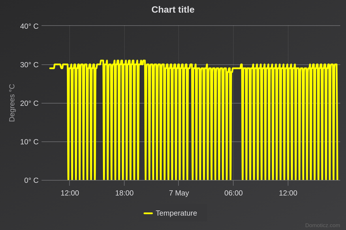

This setup works fairly well and many of the tips written in the forum are useful. However, the disk temperatures are oscillating between 0 and 31ºC for some reason
I'm on DSM7 and have been using the following script
#!/bin/bash

Does anyone has stumbled upon the same issue? Thanks in advance.

My issue is exactly the same as yours. I've changed my cronjob to output the log
*/5 * * * * /home/pi/domoticz/scripts/nas.sh 1> /dev/null 2> /home/pi/some_job.err
and every 25 minutes or so the NAS makes some unusual noise, the temperature values return zero, and the contents of the some_job.err file becomes
Timeout: No Response from 192.168.1.5
/home/pi/domoticz/scripts/nas.sh: line 44: ( - 201822598) *  / 1024 / 1024 / 1024: syntax error: operand expected (error token is "/ 1024 / 1024 / 1024")
NOTE: the code runs fine by hand and most of times. It is an occasional, but rather predictable (every 25 minutes) event, so maybe the way to address this is with a conditional statement? I've also run some tests and the timelapse of pinging does not give it away either: it is fairly constant at 600ms.
My DSM is version 7.2 and the nas.sh code that I'm using is
#!/bin/bash

I've made a few extra tests and based on this webpage
https://www.baeldung.com/linux/snmpwalk ... out-values
one can set timeout values to improve the success rate. After a few tests I was able to avoid any timeout errors, by setting the interval at 5 seconds with 3 retries. However, the disk temperature values still return zero and the NAS does some clicking noise at every 25 minutes. If I comment out the snmpwalk commands for temperature this does not happen anymore, and I've confirmed that it happens for any of my two disks. I've checked that my commands are correct using
snmpwalk -v 2c -c"mypassword" 192.168.1.5 1.3.6.1.4.1.6574.2.1.1.6
which returns
SYNOLOGY-DISK-MIB::diskTemperature.0 = INTEGER: 30
SYNOLOGY-DISK-MIB::diskTemperature.1 = INTEGER: 31
and so I am not sure what else to do...(head scratching). There is a possibly related post in synology's forum
