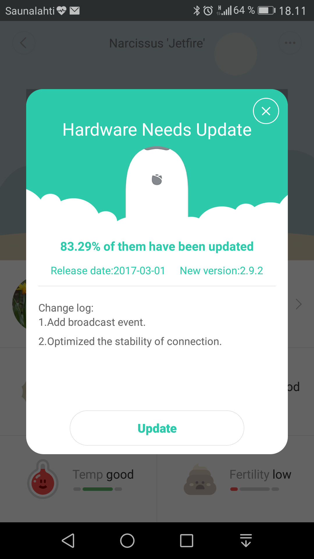

tontze wrote:You can close it via X on the right upper corner.physiker123 wrote:I looked at the app (Flower Care), but when it detects my sensors it wants to make the firmware update. I cannot delete the notification (Nexus 5x with Android 7.1), so I have to restart the app. Therefore, I only have seconds to look at the app
I looked at the FAQ, and it gave as well the values of 500 for the fertility, but 35 for the moisture. I had a look at two different plants, but the values where the same (I hope I looked right, see above).
I will just look, if 35 is too much, and then lower the value.
There is no X. I use the values in my smart home system, so I do not really need the app.
tontze
- Posts: 317
- Domoticz version: Beta Ch
- Location: Finland
Re: Xiaomi Mi Flora [Temp/Light/Moisture] BLE Sensor
Weird, i do have X what i use to prevent updatephysiker123 wrote:tontze wrote:You can close it via X on the right upper corner.physiker123 wrote:I looked at the app (Flower Care), but when it detects my sensors it wants to make the firmware update. I cannot delete the notification (Nexus 5x with Android 7.1), so I have to restart the app. Therefore, I only have seconds to look at the app
- Screenshot_20170322-181148[114].png (141.61 KiB) Viewed 5328 times
