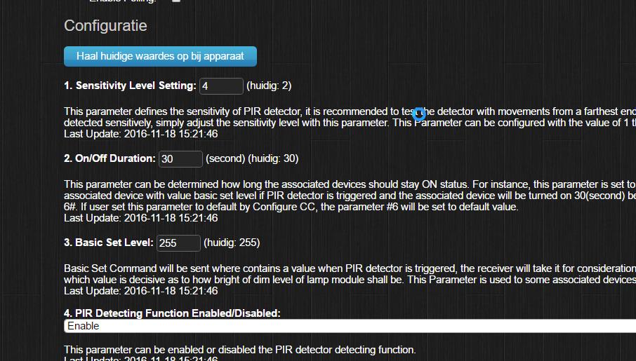

Derik wrote:cannot set my Xiaomi coolcam motion ..
The sensuality level stays on 2..
what i try, i cannot set it on 3 or 4..?

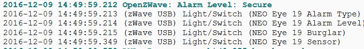

See for yourself Image

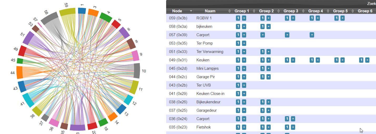

This i my Carport sensor:
Cannot set the other 3 groups:
And cannot set the 2 to 3 or 4: [ chapter 1 ]
Perhaps a update for OpenZwave perhaps necessary ?
