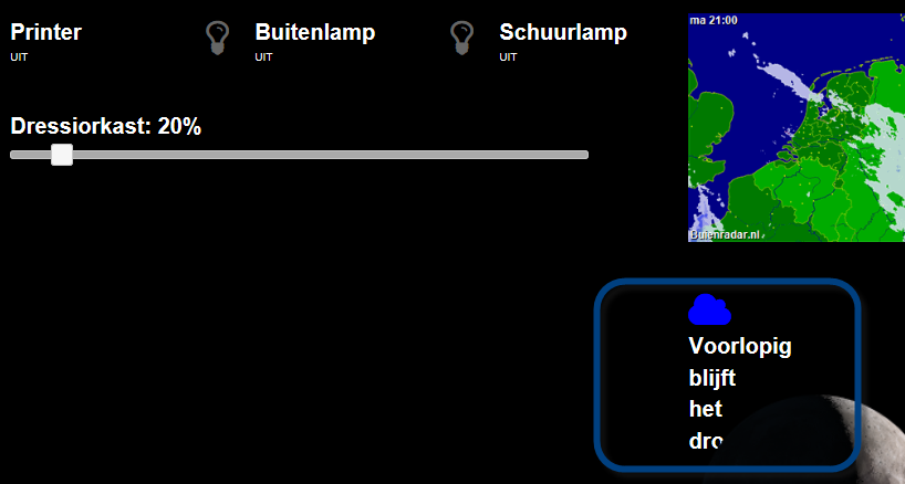

Re: Dashticz v2.0, custom positioning and multiple screens
I have been looking around for an hour now, but I can not find how to change the font-size of 1 (text) device? I want my rain prediction smaller and all the others as they are.
Can anybody tell me how to do this? Is there also a way to put the text next to the cloud?

Not at my laptop right now but i thought every block has a unique identifier-classname like '.block233'... wich you can use in css. But if not (will check this out later) I will fix thisSuperMouse wrote:Hi,
