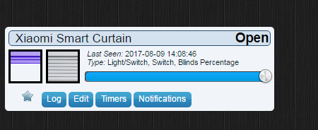

what device type would you like the Xiaomi curtain to map to?

bublikOff
- Posts: 5
- Joined: Tuesday 25 July 2017 17:31
STYPE_BlindsPercentagecorbin wrote: Friday 11 August 2017 14:34 @bublikOff
The main problem is that I dont have curtain rail and its not calibrated for end points ... for the moment Im waiting for parcel with a curtain rail for testing but have no idea when it will come. I need to understand if I can integrate Xiaomi smart curtain in smart home ... im working with designer on my new apt design and I need to finish tech things before starting apartment repair
