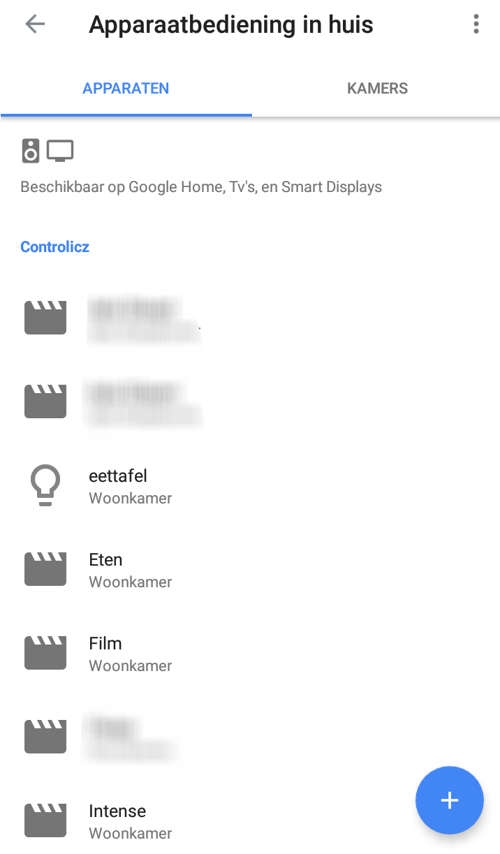

wardc
Posts: 11
Joined: Sunday 14 October 2018 13:28
Re: Controlicz - Domoticz to Google Home/Assistant integration
Post by wardc »
gijsje wrote: Thursday 11 October 2018 23:42 Now i can also see that all temp sensors are shown as a "thermostat", does google not support separate temp sensors?
And i can not yet control the thermostat from the new app it shows the ambient temp but this is actually the set point.
I have the same problem. Also noticed that RGB(W) are not recognized as such. They show as regular dimmable lights.
It's very annoying that scenes aren't showing in the app as I do almost everything in domoticz using scenes. What is strange is that they don't show in the home apps, but through the assistant app I was able to add the scenes to rooms. Haven't seen them anywhere since. I used this link to link the controlicz app to the Google assistant:https://assistant.google.com/services/a ... 8ba2?hl=nl
By first linking and then changing the settings (instellen) I was able to view the scenes. So Google probably knows about them but is ignoring them on purpose.
