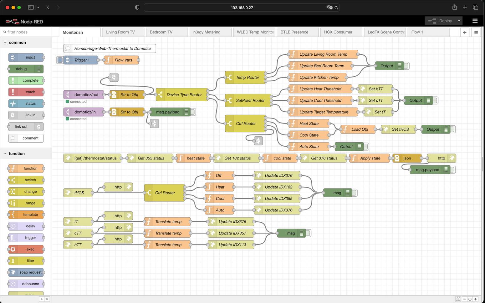

Alternative is to use homebridge-web-thermostat and NodeRed to knock up a flow that creates the required web endpoints that talk to the required virtual domoticz devices (3x setpoints: Heating, Cooling & Target) & monitors domoticz/in & out MQTT - S'how I've been running thermostats in homebridge for _years_
Screenshot 2024-03-29 at 15.26.13.jpg (199.3 KiB) Viewed 7331 times
