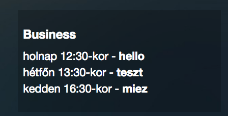

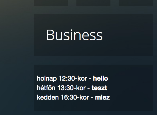

+title is a little bit too big:
I imagined title in the box itself, something like this (font-weight: 900 + padding-bottom: 5px):

Apple Calendar is broken in the new "style". Interesting that it works fine in the old style (I mean _ICALENDAR_URL). I am trying to fix it.
Google Calendar works, you must add https://crossorigin.me/ before the url.
Apple Calendar works too, but you must replace original webcal protocol with https:// + add crossorigin.me as prefix:
calendars.private = { title: 'Otthon', icalurl: 'https://crossorigin.me/https://p56-cale ... cloud.com/
Originally it was built into the code, but Rob doesn't want to hardcode crossorigin.me. I am working on a fix so you at least do not have to replace webcal with https://, but you still need to add crossorigin.me...so....
Edit, found the problem
Multiple calendar definitions broke the code.
calendars.private = { title: 'Otthon', icalurl: 'https://xyxyxyxyxyx' }
calendars.business = { title: 'Business', icalurl: 'https://calendar.google.com/basic.ics' }
only the lower calendar is working...
It's time to fix this.
Edit 2:
It seems like Rob forgot to make a loop for calendars variable, so only the last is used. :)
Please wait patiently for a fix from @Rob.
