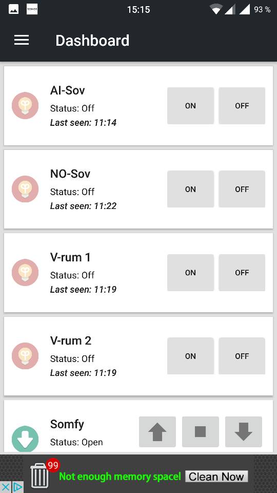

I'm having a virtual blinds device in domoticz. In the domoticz app (Beta) it still shows as on/off instead of open/closed. I read somewhere is this topic this was fixed, am I missing something? Do I have to do something to let is show as open/closed?

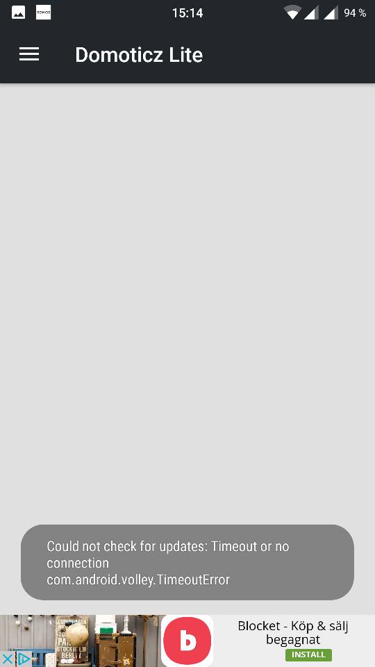

Great, the ads loads really fast, like instantly. But I get "could not check for update" - error message, so the dashboard takes up to a minute to load. So the lite app is mostly useful to view some ads now.

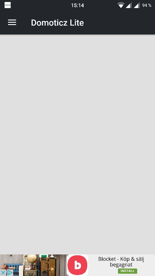

Zinken
Re: Re: Re: Domoticz app 2.0
Post by Zinken »
galadril wrote: Please check your connection settings or if there are issues with the domoticz installation.
Nothing changed on the app for this.
There isn't any issues with the installation or connection settings. The dashboard loads fine after a while, but it can take a minute.
From browser (desktop or mobile) the dashboard loads like the wind.
When opening the app, first there is a blank page with ads showing, then a toast with error message and lastly the dashboard loads.

Are you running the latest domoticz version? Beta channel?
And Did you gave the app the permissions to write to external storage? Thrn it saves cache to the sd storage?
Zinken
Post by Zinken »
galadril wrote:Are you running the latest domoticz version? Beta channel?
Haven't been prompted for storage permission but no change after adding permission manually.
Not running beta channel. So nothing on server side has changed since forever.
So the issue appeared with one of the latest updates of the app.

How did you get the up en and down arrow for the blinds? I only have on/off for my blinds. I made an export of the devicetype. Maybe this device type can also be added in the app as blinds with the up and down arrow?
