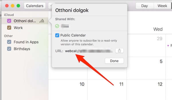

by madrian
Apple Calendar support for iCalendar plugin is here.
How to get Apple Calendar url?
How to get Google Calendar url?
On settings page go to Calendars tab, click on your Calendar name then find Private Access row (or Calendar Address if you set your Calendar public):
One thing is missing: auto update calendar (at this time it is refreshing when you hit the refresh button).
Here is my idea: maybe if we ask Rob nicely, then he will check this part. :)

mvveelen wrote:
madrian wrote:Apple Calendar support for iCalendar plugin is here.
Nice add-on !!
2 questions:
- If I make my iCloud calendar public, what 'risk' will I take? Can people see into my Calendar somehow?
- If I alter the code, like you explained earlier, and I update to the latest (beta), all code will be deleted, right?
A. nothing, only when you share that URL with someone else. No else can view your Calendar.
B, Better wait for Rob, in a couple of hours he going to merge the request.
