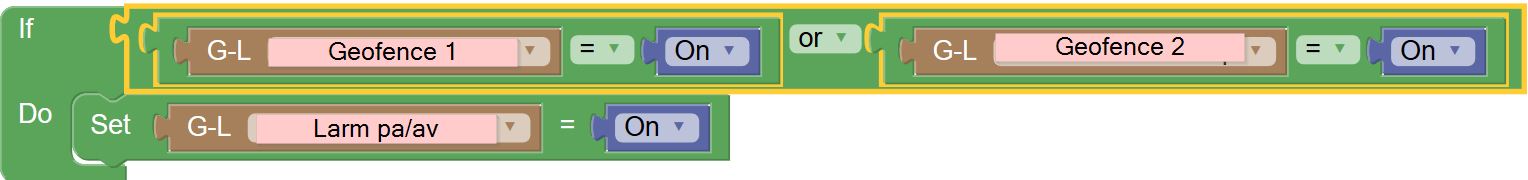

sweup wrote:sweup wrote:I want to flip "on/off" commands when both my and my wifes phone is in/outside the geofence - possible?
Personally I use three virtual switches. One for me and one for my wife. These are switched by crossing the geofence.
Then I have a third virtual switch 'Anybody home' and I switch the third one with blockly when both the other switches are off.
Thanks. Domofence switch seams to work but I don't get my alarm switch to be turned on. Does this Blockly seams ok?
I got two geofence, so "when geofence 1 and geofence 2 is on, larm should be switched on". I got a similar one for "off", bad approach?
[/quote]Hi sweup,
I think you need something like this:

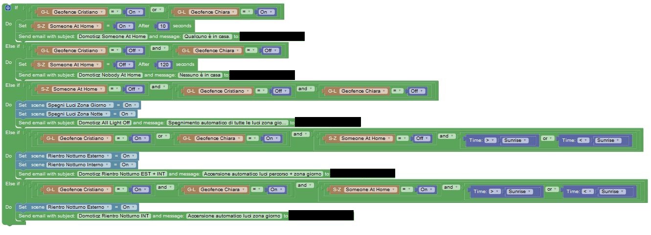

Hi guys,
this is my script to use 2 geofence with 2 smartphone. if all 2 phone are OUT the system turn off all light. if only 1 phone come home and the time is in night moded the system turn ON the light external and ON the light living. if 1 phone is in house and the 2 phone come home the system turn ON the external light.
i take some test move direclty the custom sensor on the maps and i think the system work ok.
tomorrow i test the system with the geofence on the phone.
bye bye i go to bed now !!!

The script work ok. But the geofence on the phone not work very good. I setting It with a radius of 200 mt. But when iam at home sometimes the switch is always off or the oppositive situation iam out of home and the switch is always on. Why?guantolento wrote:Hi guys,

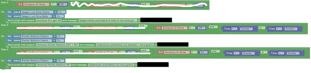

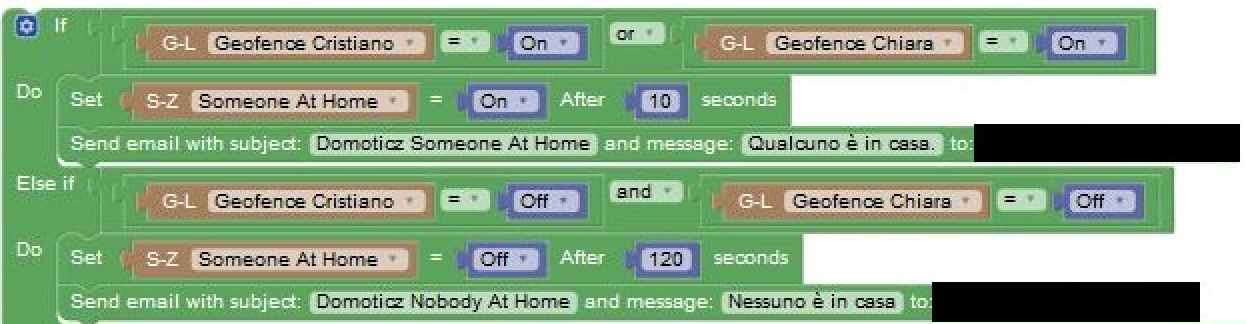

You should split your blockly into two seperate ones:
And:

Re: Geofence for Domoticz
Why i must separate in two blocky ? The script work already correct. Just for information. Thanks for all.
