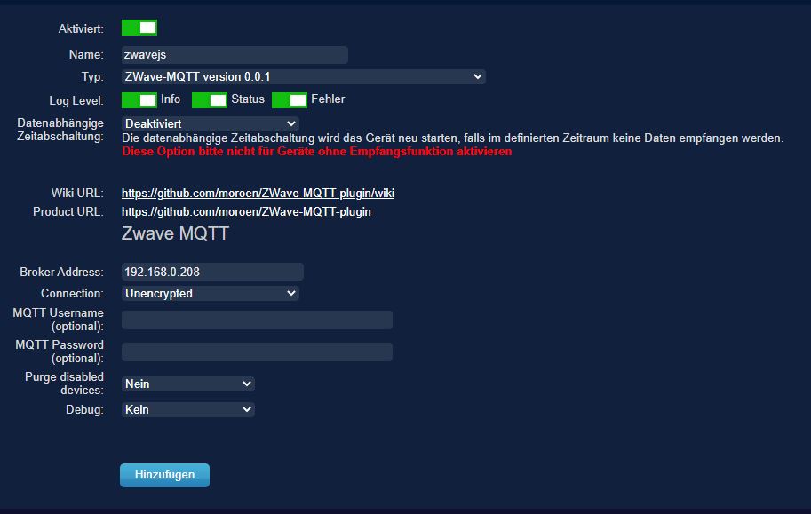

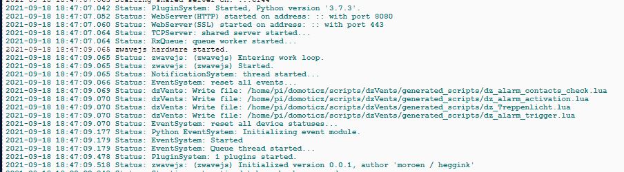

I have installed Mosquitto, zwavejs2Mqtt, Dockers and the plugin for Domoticz.
Zwavejs2Mqtt is running and I have made all interviews and changed the device names, When I am activating the plugin in Domoticz nothing happens. I was expecting that Domoticz is integrating the devices from zwavejs2mqtt. This is not the case and I have no clue what to do next. Attached the Domoticz protocol which looks good for me
Any help is wellcome

Yes I am running the latest beta. Didn't know that the latest beta already has the implementation. My fault. What do you recommend? Remove the directory under Domoticz plugins? Fact is that the auto discovery is not working. Any ideas what the settings are that the plugin will work? Does the broker address need a port number? I have testet more or less all setting without any result. I have testet the broker as well. Mosquitto is responding as expected.

Difficult to say as I am on vacation ATM. You do need a broker address an port for the plugin. Have you switched on full debug in the plugin?

Even with the latest beta version Domoticz needs the installation of the plugin. I did a fully new installation but no devices are created. Something seems to be wrong. The zwavejs Driver works perfect. The integration into Domoticz not really.

Ok, so if zwavejs is working (ie you can switch devices and can see updates from devices in the log), next check mqtt. There is a mosquito browser utility that allows you to see what messages are being sent to mqtt. There should be 2 main topics: homeassistant and zwave. Under these topics, all device definitions and device opdates should appear.
