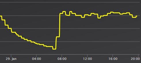

I am running 7 radiator thermostats now since 2 weeks. The only thing I would like to be added in the plugin is the more frequent update of the measured temperatures.
I now programmed the dzVents script below for doing this. The lua script did not work for me. Also I set the time between the mode switch of 3 minutes (the same as the inventors of this scan function proposed in LINK. Also made this script run every 30 minutes. As I understand communication is very limited I set switch every 30 minutes. It is doing the trick for me, see screenshot.
I am running stable Domoticz. I see only flowing lines in the graphs when the time between measurements is larger dan several hours.
Temperature update script:

The mode switching seems to work with the timings you suggest, the graph indeed looks nice! I will look into a way to implement this in the plugin. However, I will need to remove another setting if we want to make it an optional feature. Moreover, I still believe it is bit of an "ugly" solution: Your thermostat mode logs will be flooded with mode switches, and it might also drain the batteries faster.
