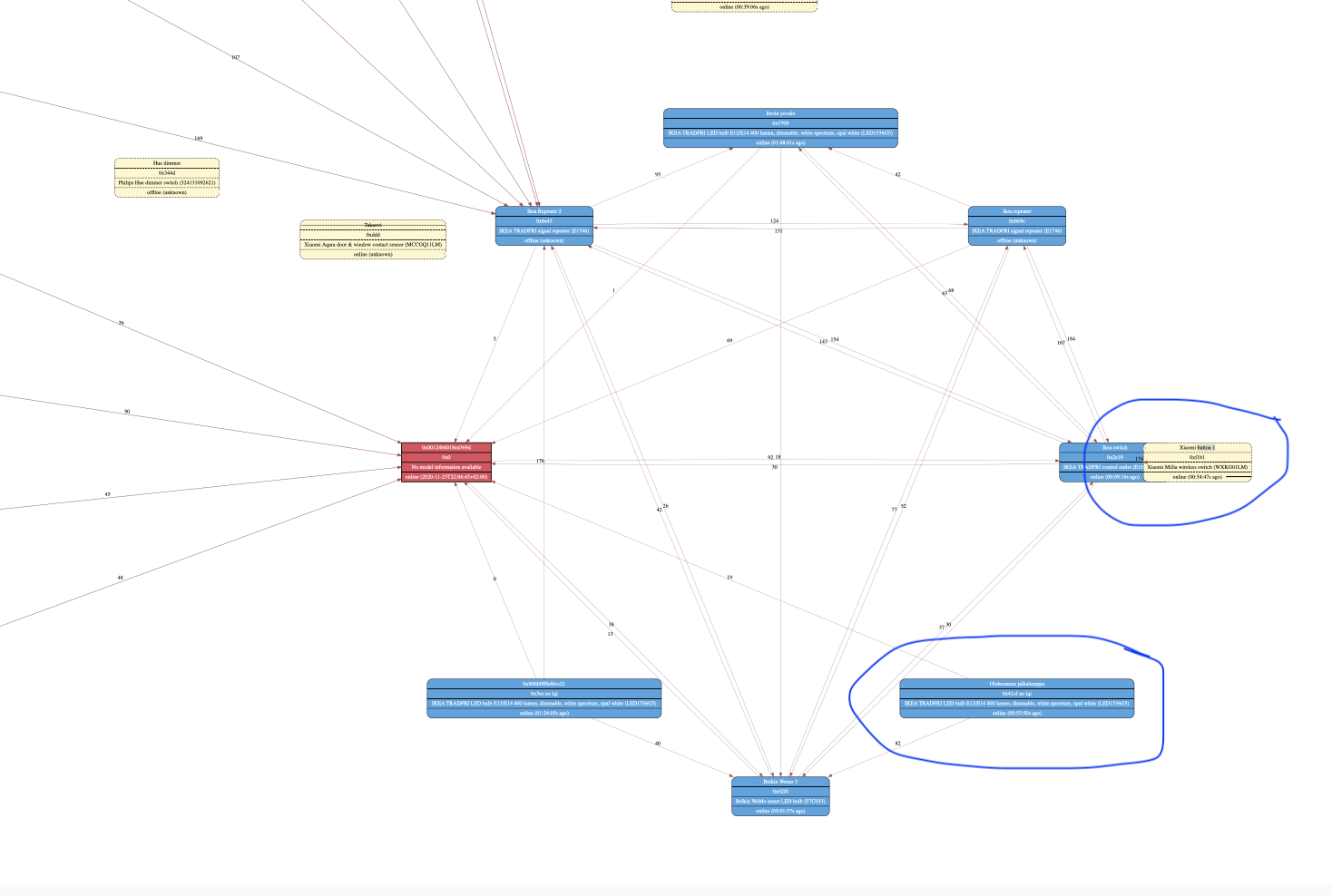

I've been a happy user for few years already, running obviously quite an old version ("Initialized version 0.0.18")... Not sure if the issue is in the plugin or somewhere else, but seems that approx 20 devices are working properly with my Domoticz setup; after some time some of the devices get lost and not seen anymore in Domoticz. They are still connected in the zigbee network map, but e.g Xiaomi buttons fail to start a script, Ikea bulb is unresponsive or a temp gauge is not sending data anymore.
So, two issues
A) tried to update the plugin to latest version, but got an error message I could not solve:
"error: Your local changes to the following files would be overwritten by merge:
adapters/__init__.py
Please commit your changes or stash them before you merge.
Aborting"
Can't recall I've fiddled with the file (possible though), but any ideas how to overcome this?
B) Assuming the update doesn't solve my problem, how to add more than 20 devices in Domoticz? This time two devices are not working, shown and connected in zigbee map, but completely unresponsive in Domoticz. Marked blue on the attachment below.
Thanks in advance for any pointers.

The updating issue was solved: git checkout adapters/__init__.py did the trick. Let's see if updating helped with missing devices as well.

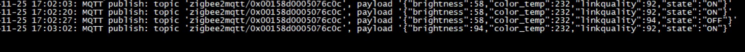

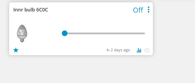

I seem to have the domoticz-UI-not-updating issue that @qwerk and @gschmidt reported back in November and @johansson thought was solved. Can anyone help with why it might still be happening, please?
I've just made a new install of the plugin and added 4 tunable white bulbs (as RGBWW) to it. I had to fix the handler for them (Innr RB278T was set as dimmable, not RGBWW), which was a one-word change.
They work okay, but the status in the domoticz UI and in the domoticz database is not reliably updated when something changes. I've used a little dzVents code to confirm what I see in the UI is also what's in the domoticz engine - screenshots below are the state of things just after I switched a bulb on and set its colour temperature & brightness.
There are no errors in the domoticz or z2mqtt logs to suggest a problem and the bulb reports a good link, yet we can clearly see the bulb being sent a 'ON' state and colour temp, which it responds to, but the UI and database do not reflect this change.
I've cleared the browser cache, tried another browser, restarted domoticz (which is latest beta 12697); nothing obvious fixed it. The fact that the dzVents code shows the same status as the UI suggests to me that the domoticz engine has not been updated with the latest status for the device.
Has anyone solved this? If not, I'll raise an issue on the plugin's github...

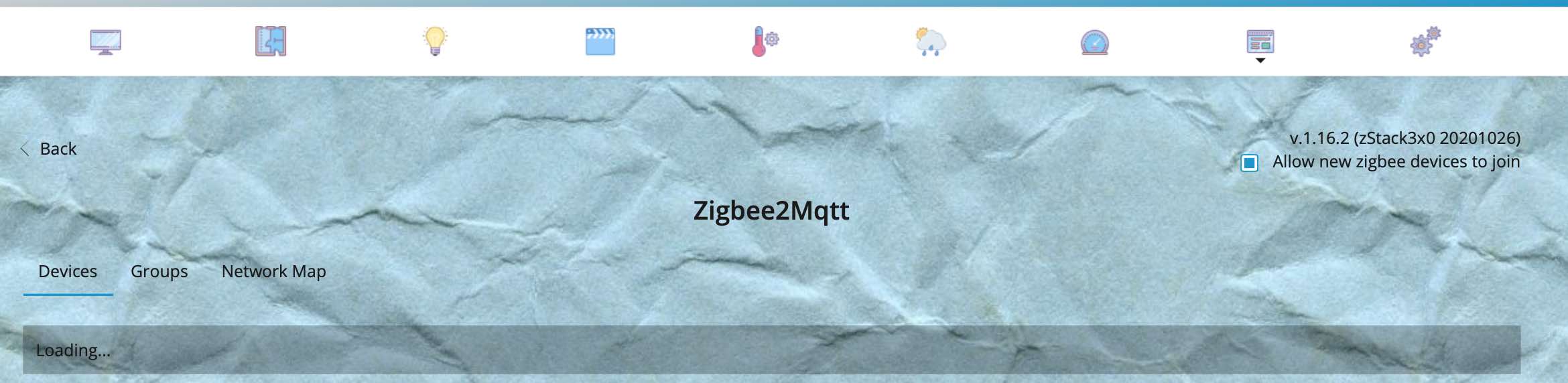

Zigbee2MQTT Page not loading anymore... Stuck on 'loading ...'
Running Domoticz Version: 2020.2 on a raspberry Pi 3b+
Schermafbeelding 2020-12-06 om 20.20.40.jpg (99.58 KiB) Viewed 3923 times
