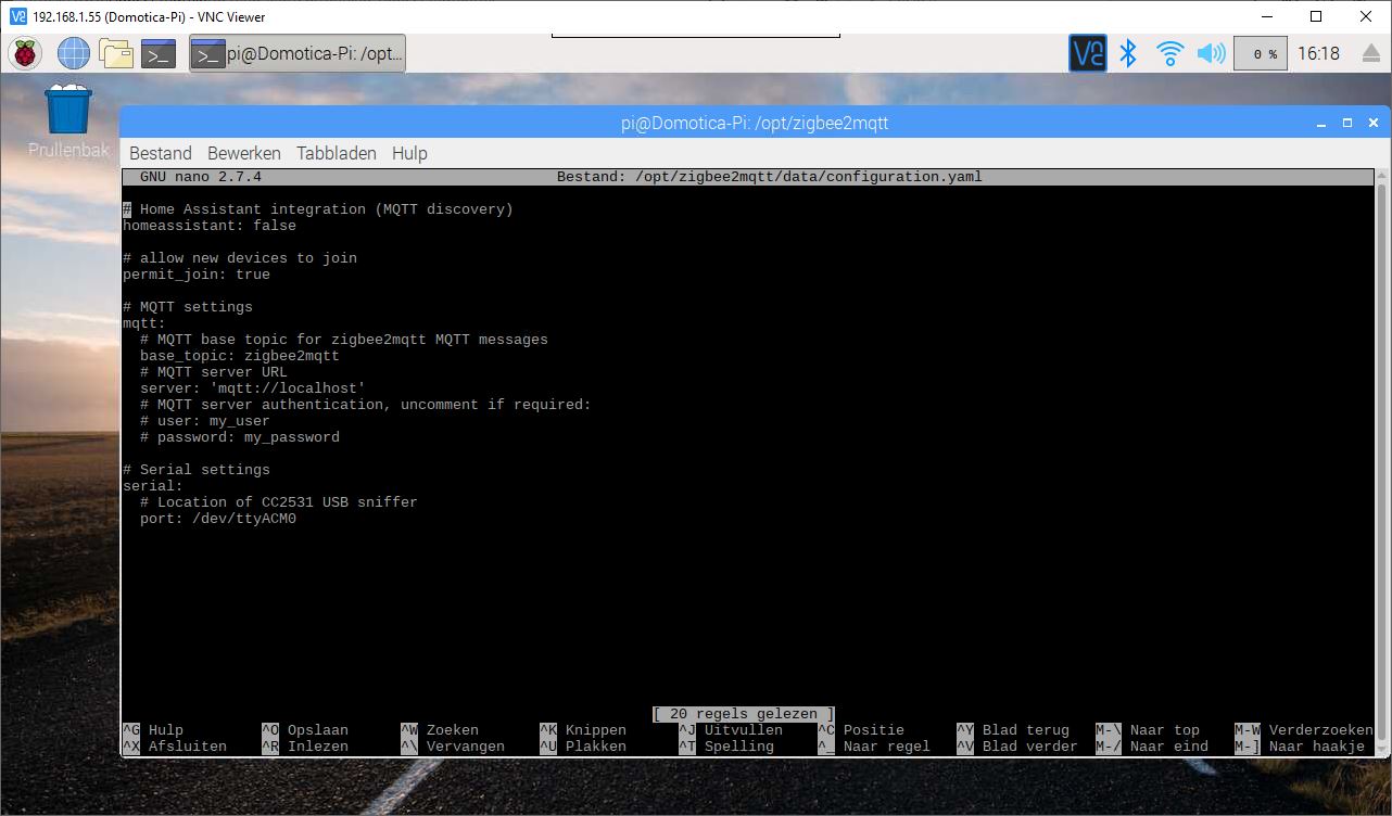

I am trying to install Zigbee2MQTT on my Domoticz system (Rpi3b).
The CC2531 USB is inserted directly on the same system.
When I run the service with "npm start", I get the error "Not connected to MQTT Server"
I have attached the LOG and the configuration.yaml.
Could somebody help me out with this?
- MQTT Server Error.JPG (133.55 KiB) Viewed 6209 times
- Configuration-YAML.JPG (112.44 KiB) Viewed 6209 times

do you have authentication enabled on your mqtt server?gschmidt wrote: Saturday 16 November 2019 16:44 Hi,
checkout my video on this topic, maby it will help you: https://www.youtube.com/watch?v=28Whi98 ... A&index=17
Last edited by snellejellep on Saturday 16 November 2019 16:57, edited 1 time in total.

make sure you have it running on the same machine as your mqtt server.
if you have enabled authentication you may run in to problems but that is a little hard to explain this way. i hope to make a video about it soon.
