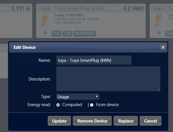

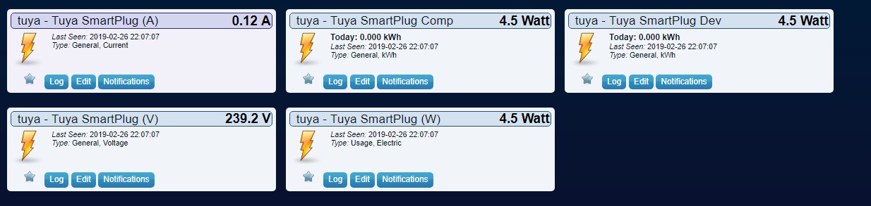

I added a separate Watt meter.
As I don't know yet how to deal with kwH ;-) or if I created the correct meter in Domoticz :lol:
i experiment with
Domoticz.Device(Name="Tuya SmartPlug #" + str(val+11), Unit=val+11, TypeName="kWh").Create()
Domoticz.Device(Name="Tuya SmartPlug #" + str(val+12), Unit=val+12, Type=243, Subtype=29, Switchtype=0, Image=0, Options="").Create()
Python is not my language at all.

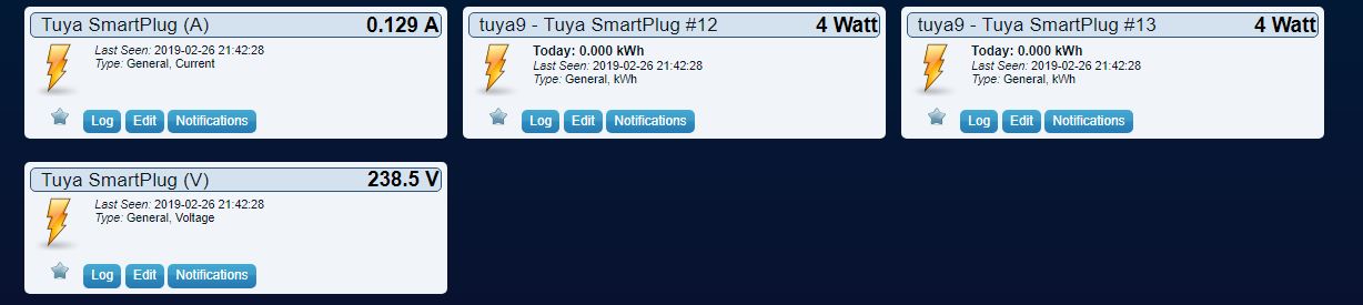

This is interesting. The plug is switched off, but sometimes it still uses different amounts of Watts somehow.
tuya plug off.JPG (43.45 KiB) Viewed 3258 times
Keep in mind the data represented comes from the plug itself.
Key 1: False Plug State
Key 2: 0 UNKNOWN
Key 4: 0.122 Ampere Key is:11
Key 5: 3.9 Watt Key is:12
Key 6:: 241.7 Voltage Key is:13
I guess the electronics are as cheap as the plug itself?

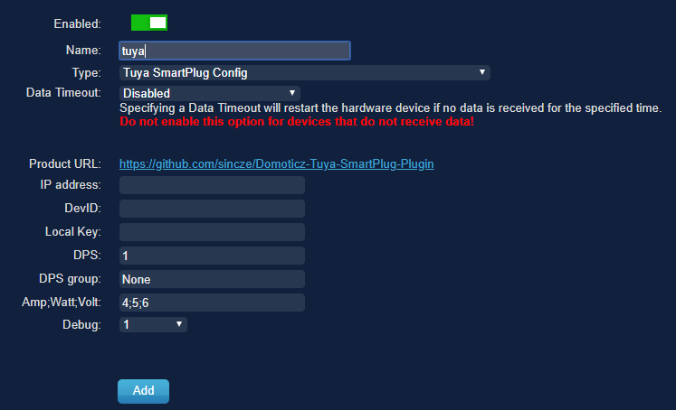

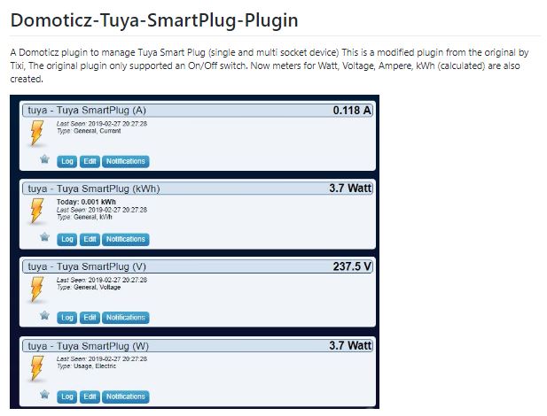

@dorenberg -> keep an eye on those dps-keys (you might need to adjust them in plugin.py -> see instructions).
I believe yours were a bit different from @jslegers and my powerplug.
I've added the plugin to https://www.domoticz.com/wiki/Plugins for future reference.
Please let me know your findings.

Hi guys,
I found solution to my problem:
Plug State Information:
{'devId': '46268374840d8e953b36', 'dps': {'1': True, '23': 30147, '18': 175, '25': 1205, '9': 0, '22': 623, '19': 260, '24': 17293, '20': 2334, '21': 1}}
Plug DPS List:
1
Then I had to adjust values in constructor:
        self.__ampere = 18  # key for Ampere
        self.__watt = 19  # key for Watt
        self.__voltage = 20  # key for Voltage
My unit IDs in Domoticz start from 14 so I edited this:
                Devices[key * 1 + 13].Update(0, str(state[str(self.__ampere)] / 1000))  # TypeName="Current (Single)
                Devices[key * 1 + 14].Update(0, str(state[str(self.__watt)] / 10) + ";0")  # kWh / Calculated
                Devices[key * 1 + 15].Update(0, str(state[str(self.__voltage)] / 10))  # TypeName="Voltage"
                Devices[key * 1 + 16].Update(0, str(state[str(self.__watt)] / 10))  # TypeName="Usage"
I thought it would work if I set the DPS to 4 in device settings but it didn't work so I had to change 10,11,12,13 to 13,14,15,16.
Works fine, no error :) I wonder how the total KWh usage is collected - is it calculated by the device or by the plugin? Is it the average of all reads?
That is a tricky one indeed.
I had to modify (edit the created device) and put in on 'calculated'.
As by default it is set to a 'device' thing.
But that data is not retrieved from the plug as far as I know so the plugin will send '0' all the time. Just do a ctrl-f for ';0'
I could not find a different plugin that showed me how to do it straight out of the box.

I modified my local plugin so now you can add the DPS values of Amp;Watt;Volt in the hardware config screen.
And it does work.. ;-)
