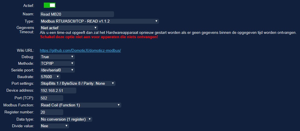

I'm testing this plugin and encountered some problems.
I' ve defined two hardware devices, one for F1(Read coil) fonction and an other for F3(Read holding register) fonction.
But both device are shown as Light/Switch !
This seem ok for F1 fonction (binary) but F3 should read a Custom sensor ?

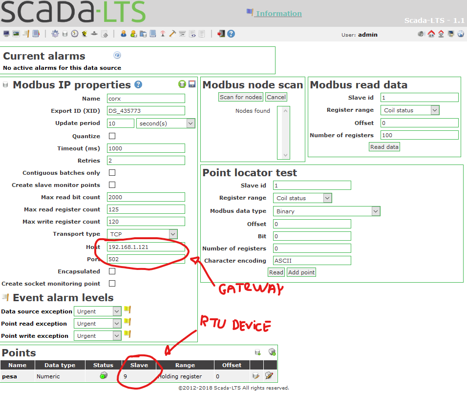

Hello Domoticx,
I install your plug in, works fine, but i have a problem.
I use a modbus gateway between RTU and TCP. When add a MODBUS TCP device in domoticz, cant select address of modbus RTU device, only ip adress of gateway.
i use it in scadabr and works fine, how can select slave address in your plugin?
Scheme: modbus RTU bus(rs485)----------- modbus gateway (RTU-TCP)------ LAN
L device 1.
L device 2...
i attach and image of scadaLTS.

Hallo,
I installed the plugins and after clean installation of Raspbian and Domoticz it works so far.
I am trying to read a coil from PLC over TCP and in debug mode. When I switched the register from on to off I see in debug mode:
2018-11-04 23:09:43.297 (Read MB20 - ModbusDEV-READ) Updating device from 1:'False' to have values 0:'False'.
2018-11-04 23:09:43.312 (Read MB20 - ModbusDEV-READ) Updating device from 0:'False' to have values 1:'False'.
When I switched from off to on in debug mode:
2018-11-04 23:10:53.304 (Read MB20 - ModbusDEV-READ) Updating device from 1:'True' to have values 0:'True'.
2018-11-04 23:10:53.319 (Read MB20 - ModbusDEV-READ) Updating device from 0:'True' to have values 1:'True'.
So far so good. Only thing is that when I switched that device, the device stay's on. When I change the data type to INT instead of no conversion the device stay's off.
The ModBus-WRITE plugin the write coil function is working verry good with payload on=1 and off=0.
Can you please help me with the read plugin?
