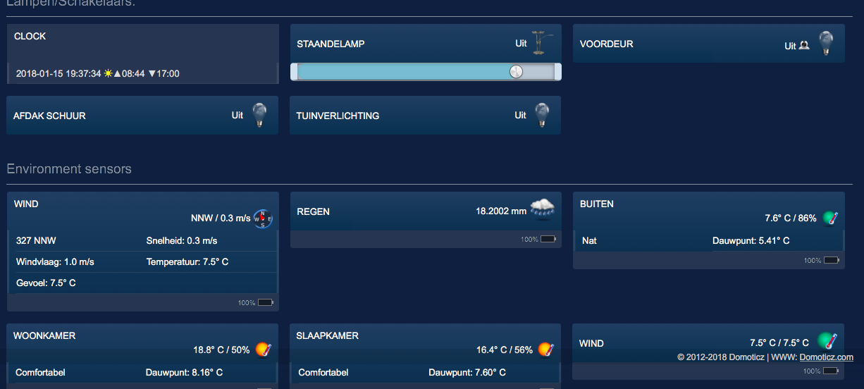

Only one thing I found, if I click on Set clock as an item, it start with one clock on the dashboard, after a few seconds I have another clock, and after a few minutes I have a lot of clocks on the dashboard...
I call it a little clock bug.. :D
do you already know about this thing???
- thuis morning i started domoticz om my iPad, it started with the default white colors of the Aurora theme, but normaly with a refresh it turned to the blue colors i conigured but now i cant het the blue colors back, even if i click save settings... everything stays white..

@ blauwebuis
Maybe it's a good idea to put a version number in the clock box which can be placed on the dashboard page..
It will be very handy to see what version everybody is talking about, and that we can follow your progression. ;-)
just found some little bugs in your new version;
-the camera is not showing it's stream...
- on the attached picture you see in the right lower corner "© 2012-2018 Domoticz | WWW: Domoticz.com". if I scrol the screen it stays in that box..
Good luck... do your best ;-)
