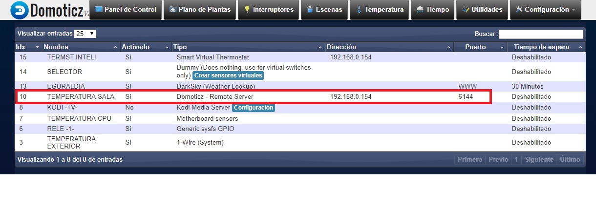

I tell you my installation, I have two pi zero w, one pi zero for the temperature probe installed in the room and the other pi zero with the relay modules next to the boiler. The idx 10 is the temperature probe of the room and for read the temperture in this pi zero I use a Domoticz-remote server.
Sin título.jpg (141.36 KiB) Viewed 4185 times

uzturre wrote: Wednesday 07 November 2018 16:26
jake wrote: Wednesday 07 November 2018 12:09 When i simply read your log, it can find a (properly defined) inside temperature sensor. Without that sensor the whole thermostat idea is useless of course. Please check the idx value in the hardware page
The idx for the temperature sensor is the one on the devices page (I assume you properly set up device sharing), not the hardware idx...
jake
Posts: 753
Re: Python Plugin: Smart Virtual Thermostat
Post by jake »
Of course, but the idx number has to be added to the svt specs on the hardware page.
uzturre
Posts: 14
Joined: Wednesday 13 June 2018 10:41
Domoticz version: 4.10717
Location: Basque Country
Post by uzturre »
Good morning:
Thank you very much for your responses:
I have already corrected the Idx because I had installed the hardware Idx and I have already put the Idx of the devices, but I can not get the SVT to work.
The pi zero that has installed the interior temperature sensor has the following IP: 192.168.0.154 and the pi zero that has the control and the relay modules and also the external temperature sensor has the IP: 192.168.0.160
When configuring the SVT hardware I have put both IPs alternately and I can not get it to work.
On the other hand I have made a programming blockly setting parameters of days and temperatures to activate the boiler and it works properly, but I like the concept of SVT more and that is why I want to work with it.

2018-11-15 11:47:16.899 Status: EventSystem: reset all events...
2018-11-15 11:47:33.816 (Termostat) Thermostat (Termostat)
2018-11-15 11:48:10.407 (Termostat) Thermostat (Termostat)
2018-11-15 11:48:36.079 Status: User: Admin initiated a switch command (52/Termostat - Thermostat Control/Set Level)
2018-11-15 11:48:36.140 Error: (Termostat) 'onCommand' failed 'KeyError'.
2018-11-15 11:48:36.140 Error: (Termostat) ----> Line 627 in '/home/pi/domoticz/plugins/SVT/plugin.py', function onCommand
2018-11-15 11:48:36.140 Error: (Termostat) ----> Line 277 in '/home/pi/domoticz/plugins/SVT/plugin.py', function onCommand
2018-11-15 11:48:36.140 Error: (Termostat) ----> Line 349 in '/home/pi/domoticz/plugins/SVT/plugin.py', function onHeartbeat
2018-11-15 11:48:36.140 Error: (Termostat) ----> Line 498 in '/home/pi/domoticz/plugins/SVT/plugin.py', function readTemps
2018-11-15 11:48:43.869 Status: User: Admin initiated a switch command (52/Termostat - Thermostat Control/Off)
2018-11-15 11:48:43.930 Error: (Termostat) 'onCommand' failed 'KeyError'.
2018-11-15 11:48:43.930 Error: (Termostat) ----> Line 627 in '/home/pi/domoticz/plugins/SVT/plugin.py', function onCommand
2018-11-15 11:48:43.930 Error: (Termostat) ----> Line 277 in '/home/pi/domoticz/plugins/SVT/plugin.py', function onCommand
2018-11-15 11:48:43.930 Error: (Termostat) ----> Line 349 in '/home/pi/domoticz/plugins/SVT/plugin.py', function onHeartbeat
2018-11-15 11:48:43.930 Error: (Termostat) ----> Line 498 in '/home/pi/domoticz/plugins/SVT/plugin.py', function readTemps
2018-11-15 11:48:47.105 Status: User: Admin initiated a switch command (52/Termostat - Thermostat Control/Off)
2018-11-15 11:48:47.165 Error: (Termostat) 'onCommand' failed 'KeyError'.
2018-11-15 11:48:47.165 Error: (Termostat) ----> Line 627 in '/home/pi/domoticz/plugins/SVT/plugin.py', function onCommand
2018-11-15 11:48:47.165 Error: (Termostat) ----> Line 277 in '/home/pi/domoticz/plugins/SVT/plugin.py', function onCommand
2018-11-15 11:48:47.165 Error: (Termostat) ----> Line 349 in '/home/pi/domoticz/plugins/SVT/plugin.py', function onHeartbeat
2018-11-15 11:48:47.165 Error: (Termostat) ----> Line 498 in '/home/pi/domoticz/plugins/SVT/plugin.py', function readTemps
2018-11-15 11:48:48.361 Status: User: Admin initiated a switch command (52/Termostat - Thermostat Control/Off)
2018-11-15 11:48:48.395 Error: (Termostat) 'onCommand' failed 'KeyError'.
2018-11-15 11:48:48.395 Error: (Termostat) ----> Line 627 in '/home/pi/domoticz/plugins/SVT/plugin.py', function onCommand
2018-11-15 11:48:48.395 Error: (Termostat) ----> Line 277 in '/home/pi/domoticz/plugins/SVT/plugin.py', function onCommand
2018-11-15 11:48:48.396 Error: (Termostat) ----> Line 349 in '/home/pi/domoticz/plugins/SVT/plugin.py', function onHeartbeat
2018-11-15 11:48:48.396 Error: (Termostat) ----> Line 498 in '/home/pi/domoticz/plugins/SVT/plugin.py', function readTemps
2018-11-15 11:48:49.672 Status: User: Admin initiated a switch command (52/Termostat - Thermostat Control/Set Level)
2018-11-15 11:48:51.147 Status: User: Admin initiated a switch command (52/Termostat - Thermostat Control/Set Level)
2018-11-15 11:48:51.187 Error: (Termostat) 'onCommand' failed 'KeyError'.
2018-11-15 11:48:51.187 Error: (Termostat) ----> Line 627 in '/home/pi/domoticz/plugins/SVT/plugin.py', function onCommand
2018-11-15 11:48:51.187 Error: (Termostat) ----> Line 277 in '/home/pi/domoticz/plugins/SVT/plugin.py', function onCommand
2018-11-15 11:48:51.187 Error: (Termostat) ----> Line 349 in '/home/pi/domoticz/plugins/SVT/plugin.py', function onHeartbeat
2018-11-15 11:48:51.187 Error: (Termostat) ----> Line 498 in '/home/pi/domoticz/plugins/SVT/plugin.py', function readTemps

Tarzan737 wrote: Thursday 15 November 2018 11:58 i can´t get this to work.. not in Auto.. if forced it turns the heater on.
no problems with installation and i can find the hardware SVT and put in correct idx numbers for temp sensors and heater..
no login or passwords enabled..
The issue is really with your temperature sensors... I suspect you are relying on combo devices (e.g. devices that have both temp + humidity values for instance) instead of "simple" temperature sensors...
Can you please issue the following in a browser and send me the output by pm ?
http://192.168.0.14:8080/json.htm?type=devices&filter=temp&used=true&order=Name
