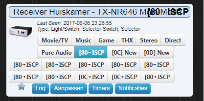

I also see this happening
[img]
[/img]
And a lot of these in the message log
2017-08-06 23:20:40.244 Error: (Receiver Huiskamer) PyDomoticz_Log failed to parse parameters: string expected.
2017-08-06 23:20:40.244 Error: (Receiver Huiskamer) 'PyDomoticz_Log' failed 'ValueError':'embedded null character'.
I need some surrounding log items to determine where this occurs.
For the strange modes, surrounding logs and preferably the data received would help. If you enable debug, it should also log the frames received from the receiver.
On all of the above, do you now what you did, to generate the issue?

So, i removed all the strange modes from the selector switch and turned the receiver on again. All the strange modes are created again and this is the log:
2017-08-07 10:24:24.927 (Receiver Huiskamer) DataSize: 10
2017-08-07 10:24:24.927 (Receiver Huiskamer) Version: 1
2017-08-07 10:24:24.927 (Receiver Huiskamer) Reserved: [0x0][0x0][0x0]
2017-08-07 10:24:24.927 (Receiver Huiskamer) eISCP Data : !1RAS
2017-08-07 10:24:24.927 Error: (Receiver Huiskamer) PyDomoticz_Log failed to parse parameters: string expected.
2017-08-07 10:24:24.927 Error: (Receiver Huiskamer) 'PyDomoticz_Log' failed 'ValueError':'embedded null character'.
2017-08-07 10:24:24.927 (Receiver Huiskamer) Found ISCP frame

2017-08-07 10:24:26.381 (Receiver Huiskamer - TX-NR646 Main Mode) Updating device from 1:'90' to have values 1:'80'.

One more thing. Changing mode and volume works using blocky and the percentage option! Good job, thank you! ;)
The strange modes are also created when you have "create new devices" disabled. Changing the mode from within Domoticz results in strange modes reported in the selector switch. When choosing Music it switches to Stereo (when in BD/DVD source) and Movie/TV switches to [0C] New

@JimmyH1969,
Ok, I think:
Is the root of all evil.
However, I need the received data (something like)
2017-08-07 10:24:26.381 (Receiver Huiskamer) Received 26 bytes of data:.
2017-08-07 10:24:26.381 (Receiver Huiskamer) 49 53 43 50 00 00 00 10 00 00 00 0a 01 00 00 00 21 31 4c 4d ISCP............!1LM
2017-08-07 10:24:26.381 (Receiver Huiskamer) 44 38 30 1a 0d 0a .. .. .. .. .. .. .. .. .. .. .. .. .. .. D80...
That is just before this occurs, there is probably some 'strange' data in this frame.
You're running this on Windows? I happen to have the same receiver, running Domoticz on Linux, I don't have this issue, so it might be that there is a difference in how data is received on Windows that causes this.

@JimmyH1969,
I've changed how the end of eISCP data is detected. I think this should solve the issue. Apparently the old method behaved differently on some platforms. And to be honest, it wasn't completely correct, however it still should have worked, according to my humble opinion.
The new version is on Github in the development branch.
Regards,
Jorg

jorgh,
Removed old plugin, Updated the plugin, restarted Domoticz. Created the device again and it's still the same. It's still creating :|[80] New|[0C] New
I disabled all other hardware (Z-wave, RFX etc) so i could get more logging. Hope it helps. This is it from the beginning:

@JimmyH1969,
Well, I think this is actually the intended behavior :D
But let me explain.
The receiver only publishes a small number of listening modes through the XML. These are the modes that you can select using the Onkyo remote app (or the infrared remote). However, some of them are not actually modes, but pressing the button cycles through a number of modes.
Now Onkyo has created a lot of HT Amps, and they all support different modes. So what the plugin does, it creates a 'New' mode, if it is first detected. As I don't know what it's called, I create the mode once its first detected using the following format '[80] New'. Where '80' is the mode number and 'New' the description, obviously the mode number differs from mode to mode. Now if you edit the selector, you can change the 'New' part of the level name to something like 'Surround 5.1' of whatever best describes the listening mode. Just be sure, to leave the '[80]' or whatever value is there in place, as this is used to lookup the mode if it is detected again.
The [80->ISCP in the button, was actually wrong, I hope I fixed that in the latest update. It prevented subsequent detection of the mode, and thus creating a lot of wrong new modes.
Kind regards,
Jorg

Post by JimmyH1969 »
jorgh,
I think i understand :-)
It means there are more listening modes and they are being created on the fly, depending on the receivers response... right?
I'm allright with that :D
Stereo, direct and Pure Audio work as expected
It seems that repeatedly klicking on Movie/TV for example cycles true all the available sound options. I can't see what the receiver is doing, cause i'm at the office, but this makes sense.
Hope nobody is home trying to listen to something :lol:
Thanks for the help, patience and the good job. Any idea if Internet Presets are going to be in a feature version?
Tnx again!

Just for the record:
I dont see the 80->ISCP buttons any more. That's good, but it stil keeps creating new buttons.
I renamed them all to the corresponding sound format, for example "Pro Logic" and keep pressing the Movie/TV button untill the receiver switches to "Pro Logic" again, it creates a new button.
It looks like it creates a "[80] New" (or whatever) button when a new soundformat is chosen (for example Pro Logic). When i rename that one to Pro Logic and switch until the receiver is on Pro Logic again, it creates another "[80] New" button. Seem logic ofcourse, cause the initial button is renamed.
I can live with it, just my 2 cents on this

JimmyH1969 wrote:Just for the record:
You should leave The [80] in place. The plug-in uses that to match The level with the code the receiver sends. You can replace New with a more appropriate name.
