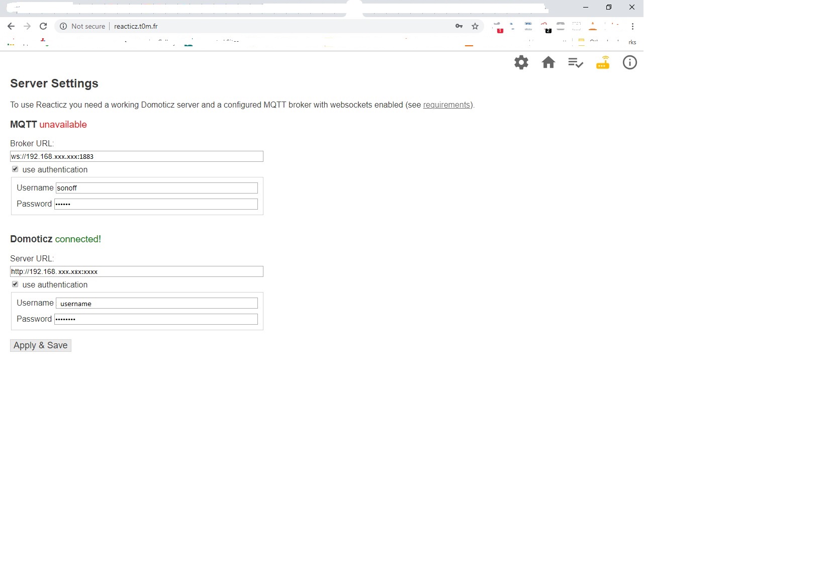

Hi guys, just having some trouble getting this going.
Im connected to my Domoticz but can't seem to connect to Mosquitto, I have the right address and port.
I have added the user and password as sonoff (to be changed later maybe :-) )
but is will not connect
I have used this commabd in terminal to listen:
mosquitto_sub -d -u sonoff -P sonoff -t dev/test
and this command to send:
mosquitto_pub -d -u sonoff -P sonoff -t dev/test -m "testing testing sonoff sonoff"
this works but for some reason Reacticz is having none of it, any help appreciated

No, Reacticz is also needing the http:// (or https:// in my case) connection to Domoticz (like you can see on the public server https://reacticz.t0m.fr/ or on the picture below). And this is the issue with Domoticz 2025.2.
MQTT connection is still working (sure, nothing was changed here). But for the Domoticz connection it will show "unavailable". So the issue has to be somewhere in between Reacticz to Domoticz.
