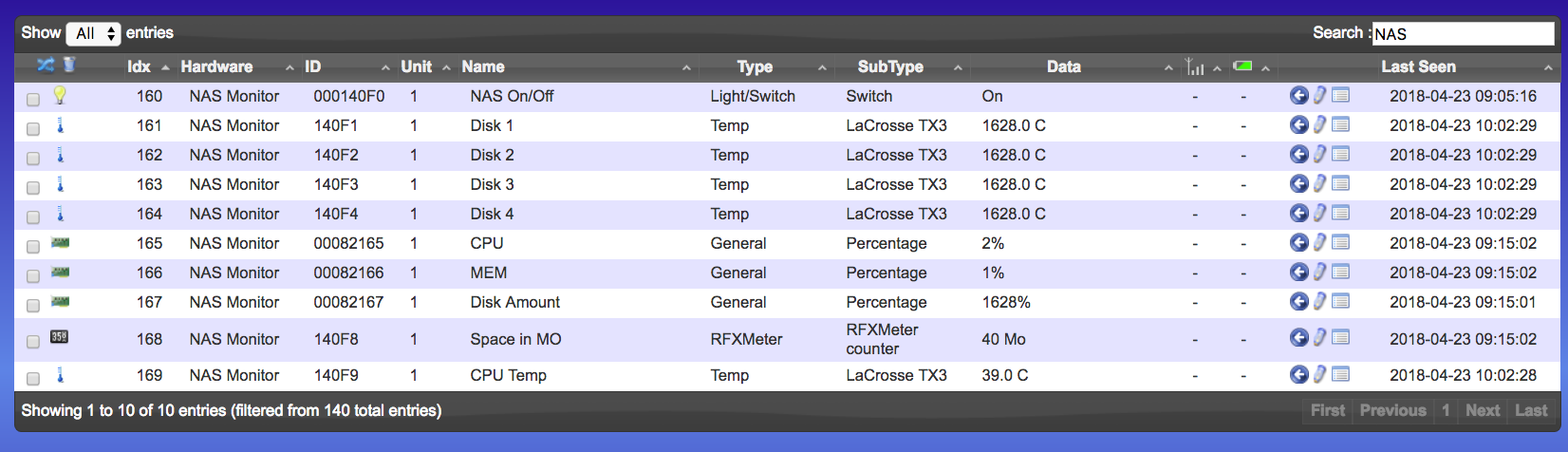

So, I think I'm almost there with this script. Still, I also think that there is something not quite right. This is the script I use. I only have 4 drives, so commented out where it looks for more drives.
#!/bin/bash
 # Settings
 NASIP="192.168.0.10"      # NAS IP Address
 PASSWORD="<<PASSWORD>>"        # SNMP Password
 DOMO_IP="192.168.0.11"    # Domoticz IP Address
 DOMO_PORT="8080"            # Domoticz Port
 NAS_IDX="160"                # NAS Switch IDX
 NAS_HD1_TEMP_IDX="161"       # NAS HD1 Temp IDX
 NAS_HD2_TEMP_IDX="162"       # NAS HD1 Temp IDX
 NAS_HD3_TEMP_IDX="163"       # NAS HD2 Temp IDX
 NAS_HD4_TEMP_IDX="164"       # NAS HD1 Temp IDX
 #NAS_HD5_TEMP_IDX="55"       # NAS HD1 Temp IDX
 #NAS_HD6_TEMP_IDX="56"       # NAS HD1 Temp IDX
 #NAS_HD7_TEMP_IDX="57"       # NAS HD1 Temp IDX
 #NAS_HD8_TEMP_IDX="58"       # NAS HD1 Temp IDX
 NAS_HD_SPACE_IDX="168"       # NAS HD Space IDX in Go
 #NAS_HD_SPACE_PERC_IDX="63"  # NAS HD Space IDX in %
 NAS_CPU_IDX="165"            # NAS CPU IDX
 NAS_MEM_IDX="166"            # NAS MEM IDX
 NAS_CPU_TEMP="169"		   # NAS CPU Temperature

When I run this script manually, I see the following:
./nas.sh

pi@domo-server:~/domoticz/scripts $ sudo nano nas.sh
pi@domo-server:~/domoticz/scripts $ ./nas.sh
Screen Shot 2018-04-23 at 10.04.19.png (219.67 KiB) Viewed 9690 times

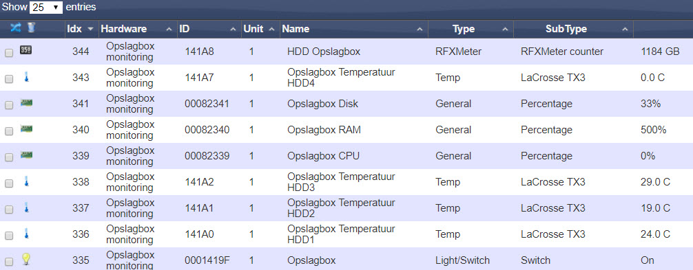

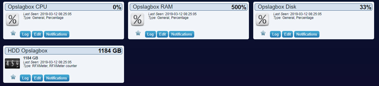

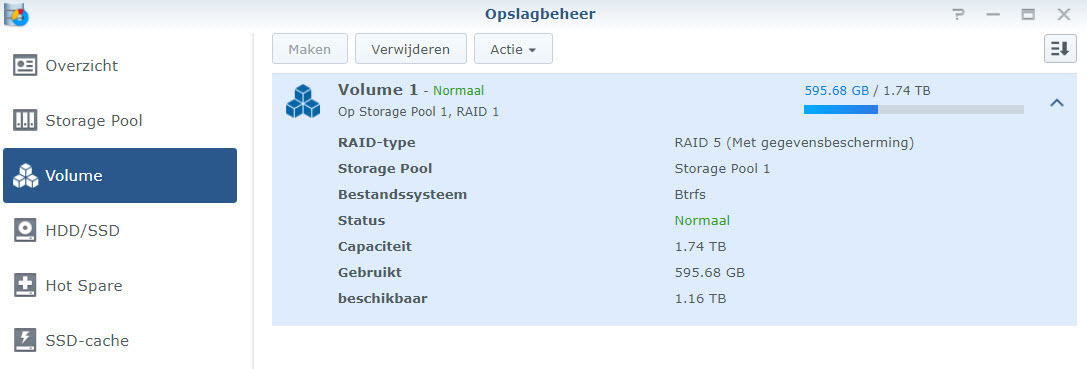

Hello there,
I have build a Xpenology Nas based on model 3615XS with DSM 6.2
RAID5 setup with 3 1TB disks, and total 6gb ram modules (2+2+1+1 gb modules)
I have used the script from the wiki, blurred here my ipadress settings etc
#!/bin/bash
 # Settings
 NASIP=""       # NAS IP Address
 PASSWORD=""            # SNMP Password
 DOMO_IP=""      # Domoticz IP Address
 DOMO_PORT=""            # Domoticz Port
 NAS_IDX="335"                 # NAS Switch IDX
 NAS_HD1_TEMP_IDX="336"        # NAS HD1 Temp IDX
 NAS_HD2_TEMP_IDX="337"        # NAS HD2 Temp IDX
 NAS_HD3_TEMP_IDX="338"
 NAS_HD4_TEMP_IDX="343"
 NAS_HD_SPACE_IDX="344"        # NAS HD Space IDX in Go
 NAS_HD_SPACE_PERC_IDX="341"   # NAS HD Space IDX in %
 NAS_CPU_IDX="339"             # NAS CPU IDX
 NAS_MEM_IDX="340"             # NAS MEM IDX

It works for disk temps, cpu percentage used and harddisk % used, these are correct.
But there is something wrong with the memory, it is giving 500% and the harddisk counter is giving only 1 result, I dont know if thats right.
12-3-2019 08-31-40.jpg (66.52 KiB) Viewed 8425 times
12-3-2019 08-29-36.jpg (144.28 KiB) Viewed 8425 times
12-3-2019 08-28-39.jpg (105.33 KiB) Viewed 8425 times
