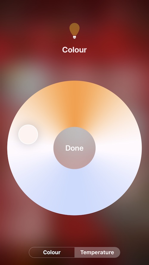

Temperature sensors are still supported only in 3rd apps (EVE)?
Edit: seem to be not. My simple virtual temperature sensor is working in the Homekit app. But I have other BME280 sensor Baro+Temp+Hum, which is not supported, only in EVE.
I have a Yeelight RGBW lamp, which is recognized correctly as RGBW(W) / Lighting Limitless/Applamp. Everything is working fine, unless that I can't set a nice soft-warm color. I can set all RGB color, but something around 3500K not. :evil:
From LUA script I set like this:
2018-02-28 20:59:27.519 LUA: sudo echo -ne '{"id":1, "method":"set_scene","params":["ct",3572, 75]}\r\n' | nc -w1 192.168.1.82 55443
2018-02-28 20:59:27.519 LUA: Color Temp= 3572
Screenshot:
This setting in the reality is ice blue, if I move a little bit higher it's immediately set lamp to orangeish-red color.
