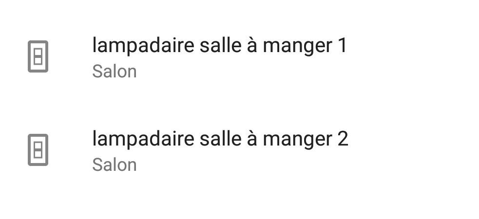

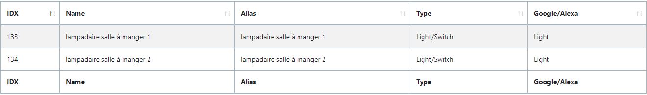

I use controlicz since the begin and it gives me lot of joy ! I've add some new devices today (2 mysensors relays) to switch 2 lights. I've add them to the plan in domoticz, sync my devices in google home. They aren't recongnized as lights but as switchs so I can't controle them with the voice command "switch on the lights of the living room".
They are configured as lights in domoticz so I don't understand why controlicz don't recognize them as lights to.
Maybe I have made a mistake ?
Thank's a lot for the very good work and hope you have the solution of my issue !

Post by Madgeni »
Hi there - can you mail me from your Controlicz profile, and i'll take a look

Madgeni wrote: Monday 18 June 2018 9:11 Hi there - can you mail me from your Controlicz profile, and i'll take a look
It's done !
Madgeni
Posts: 1571
Re: Controlicz - Domoticz to Google Home/Assistant integration
Post by Madgeni »
it's fixed :)
