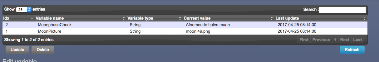

Try this:
Screen Shot 2017-04-25 at 08.48.15.png (54.27 KiB) Viewed 2846 times
You need to take a look at the 'User variables' tab and note the idx of the MoonPicture row.

EdKo66 wrote:Try this:
Thank you that was the problem
