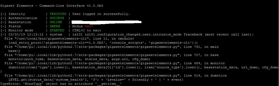

Re: Gigaset Elements Cli - domoticz support
Hello Dynasticorpheus, thank you for your code that works well at home to change the alarm mode. But, I have an error message as soon as the alarm is changed on the gigaset site.
Could you help me STP?
- Domoticz.JPG (129.34 KiB) Viewed 3901 times
Thanks for reporting, I logged this issue at github and will have a look once I have some timeRaptor wrote: Friday 01 March 2019 12:25 Hello Dynasticorpheus, thank you for your code that works well at home to change the alarm mode. But, I have an error message as soon as the alarm is changed on the gigaset site.
Finally had the time to look at this. Now solved in latest dev version, let me know if it's also the case for you.Raptor wrote: Friday 01 March 2019 12:25 Hello Dynasticorpheus, thank you for your code that works well at home to change the alarm mode. But, I have an error message as soon as the alarm is changed on the gigaset site.
