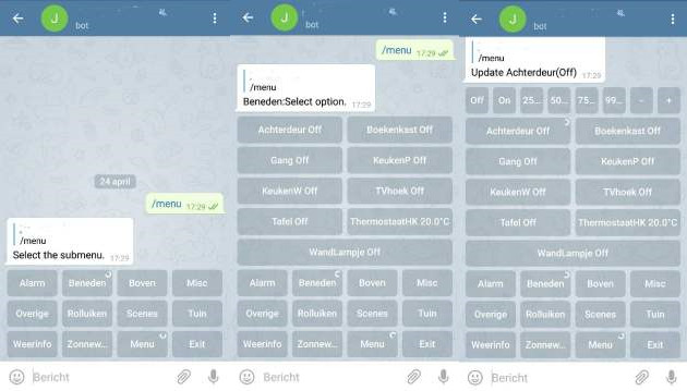

Post by jvdz »
I am still in develop mode, but have most of the basic running for the inline-keyboard functionality of Telegram, available in Bot API 2.0.
Here is a sneak peak of how it currently looks:
Inline DTGBOT
Inline DTGBOT
More to follow soon,
Jos

Post by blackdog65 »
Looking good!
Will multi-position/selector switches work? Currently they just show off and on (in Dutch).
This is rapidly becoming a cool control panel.
Sean

Post by jvdz »
blackdog65 wrote:Will multi-position/selector switches work?
I have the basics also running for the selector switch in the new version.
Hadn't looked at it yet and indeed required some changes in the process.
Jos
