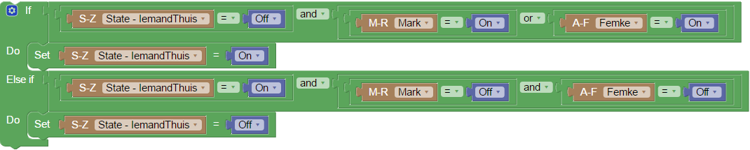

sweup wrote:
Thanks. Domofence switch seams to work but I don't get my alarm switch to be turned on. Does this Blockly seams ok?
I got two geofence, so "when geofence 1 and geofence 2 is on, larm should be switched on". I got a similar one for "off", bad approach?
This is how I switch my 'Somebody home?' virtual switch:
Schermafdruk 2016-11-12 11.35.54.png (35.48 KiB) Viewed 3905 times

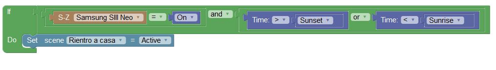

Good morning,
it's ok a blocky script like this or i take some mistake ?
in the setting of the script blocky what do mean "event active" i think i must flag it if i want to "use" the script or not flag if the script is "out of use". it's ok ?
rientro a casa.JPG (27.41 KiB) Viewed 3900 times

Hello, using the script post under i have a problem. when iam at home the light in the scene are always "on".
anyone can help me ?

Thanks for your effort. Why do you have "Or" in your first logic and then "And" in your second logic (ie Mark and Femke)? I tried "And" for both logics but the alarm status is not triggered. Im thinking if Google Daze feature mess things up.
Appesteijn
Posts: 134
Joined: Friday 10 April 2015 23:53
Re: Geofence for Domoticz
Post by Appesteijn »
sweup wrote: Thanks for your effort. Why do you have "Or" in your first logic and then "And" in your second logic (ie Mark and Femke)? I tried "And" for both logics but the alarm status is not triggered. Im thinking if Google Daze feature mess things up.
Because Mark OR Femke could enter the geofence (so one of us) and then somebody is home, while I only want to switch 'someone home' to 'off' when we are both away.
You could check 'Show current states' to see if you check against the correct 'state-name' (on/off) in the blockly.
