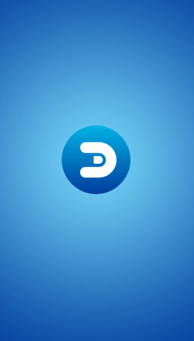

A other issue is that on my Android I often get the Dromo App background.. And nothing happens...I've got to restart the app
