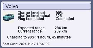

I just wrote some new text for my Volvo text sensor.
        if domoticz.devices('Volvo-aangesloten').state ~= 'Disconnected' then
            carConnected = 'Connected'
            carConnected = 'not Connected'
           if laadvermogen > 1000 then
            laadvermogen = domoticz.devices('Laadpaal').actualWatt/1000
            laadvermogen = 3600/1000  -- Watt to kWh
        -- calculate range
        local batteryCapacity = 79 -- kW
        local certainRange = 25    -- kWh/100km
        local currentRange = math.floor((domoticz.devices('XC40-ChargeLevel').state * batteryCapacity)/certainRange)
        local expectedRange = math.floor((domoticz.devices('XC40 battery charge set').levelVal * batteryCapacity)/certainRange)
        -- laadtijd berekenen tot dynamisch
        local resttijd = (batteryCapacity/100)*((domoticz.devices('XC40 battery charge set').levelVal - domoticz.devices('XC40-ChargeLevel').state))/laadvermogen
        domoticz.log('Battery set - Battery state '..domoticz.devices('XC40 battery charge set').levelVal..' - '.. domoticz.devices('XC40-ChargeLevel').state.. 'Laadvermogen : '..laadvermogen,domoticz.LOG_DEBUG)
        -- resttijd = round(resttijd,2)
        uren, honderdsten = math.modf(resttijd)
        minuten = honderdsten*60
        minuten = math.floor(minuten+0.5)
        -- certain range based on 25 kWh/100km
        domoticz.devices('Volvo').setIcon(107)
        domoticz.devices('Volvo').updateText('Charge level set &nbsp;&ensp;&emsp;&emsp;' .. tostring(domoticz.devices('XC40 battery charge set').levelVal) ..'%'..
            '\n Charge level actual &nbsp;&emsp;' .. tostring(domoticz.devices('XC40-ChargeLevel').nValue) ..'% '..
            '\n Plug connected &emsp;&emsp;&emsp;' .. carConnected ..
            -- '\n Plug connected &emsp;&emsp;&emsp;' .. chargingState ..
            '\n \n \n &emsp;&emsp;&emsp;&emsp; Expected range &ensp;&emsp;&emsp;' .. expectedRange ..' km '..
            '\n &emsp;&emsp;&emsp;&emsp; Current range &nbsp;&emsp;&emsp;&emsp;' .. currentRange ..' km'..
            '\n \n &emsp; Charging to '..tostring(domoticz.devices('XC40 battery charge set').levelVal)..'% : '.. tostring(uren) .. ' hours, ' .. tostring(minuten) .. ' minutes'..
            '\n &nbsp;')
Up till now it displayed Charging state and Set charging state.
It now displays Expected Range and Actual Range as well.
Range is calculated using an electricity consumption of 25 kWh/100 km which is based on the Spritmonitor consumption.
In summer our Volvo uses 23 kWh/100 km, in winter 25 kWh/100 km
