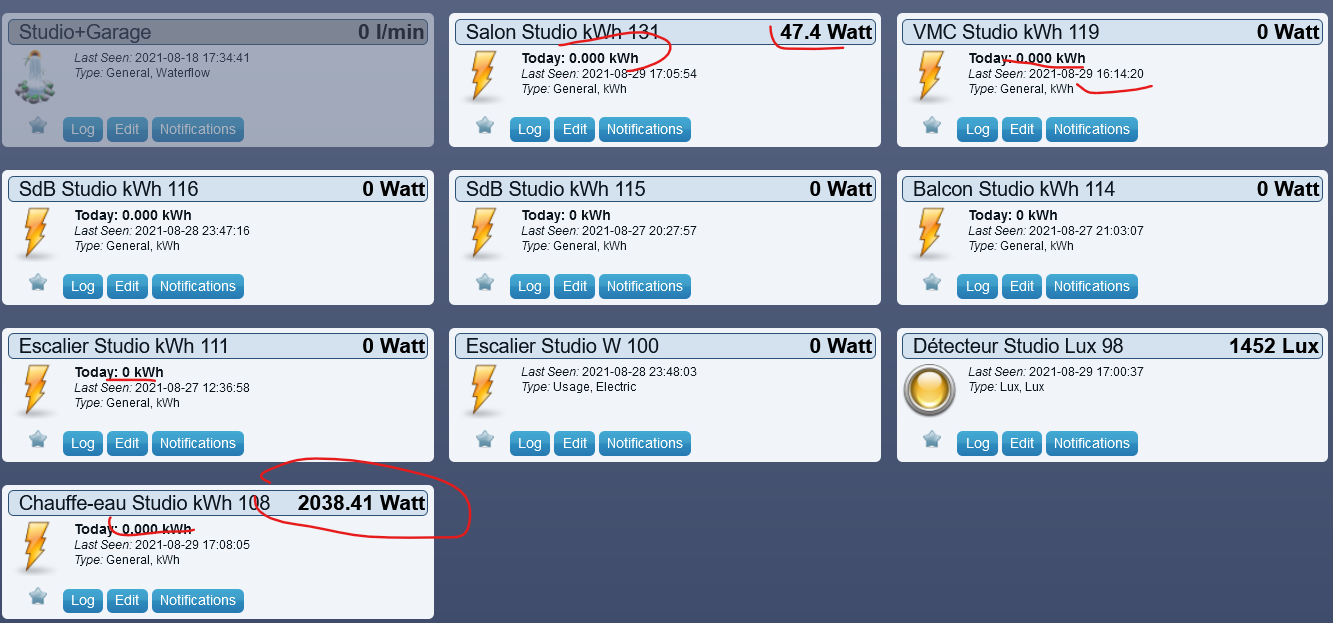

Is it just me or is it a bug that I don't get the kwh data ?
Re: zwavejs2mqtt
Posted: Sunday 29 August 2021 16:56

Varazir wrote:Is it just me or is it a bug that I don't get the kwh data ?
I've not found the time to look into this. Been away.

heggink wrote: Sunday 29 August 2021 17:08
Sent from my SM-G980F using Tapatalk
It seems to be the same for me
Screenshot 2021-08-29 171051.png (122.34 KiB) Viewed 2150 times

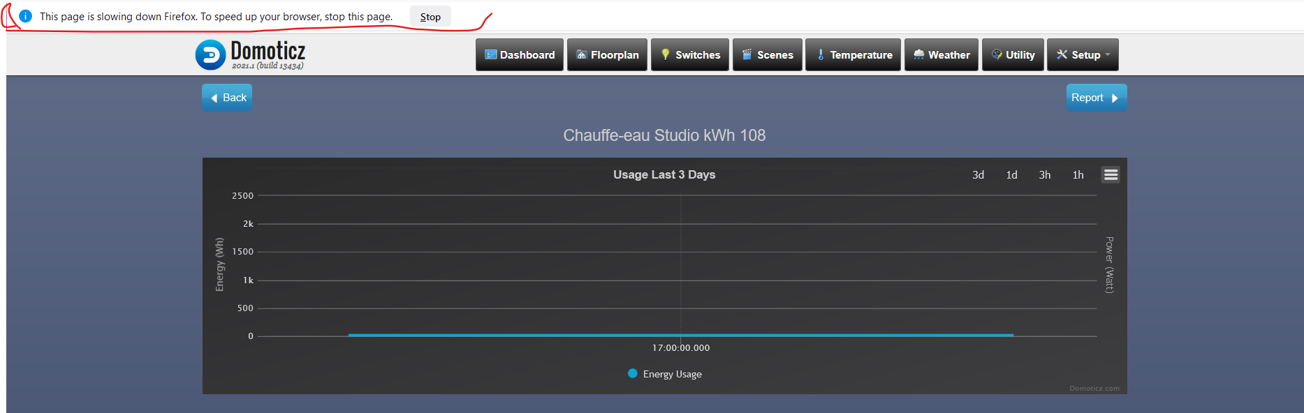

Also when on the Log to get the history, the browser alert on performance issue
Screenshot 2021-08-29 170432.png (85.28 KiB) Viewed 2150 times

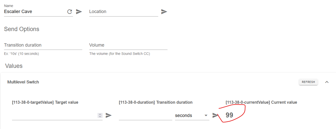

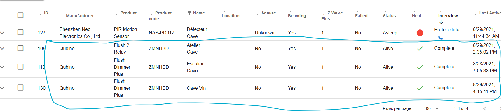

One device doesn't update the status in dz, neither in zwavejs2mqtt
Qubino ZMNHDD
To On, it is ok
To Off, no change
Screenshot 2021-08-29 172452.png (35.73 KiB) Viewed 2150 times
The network seems ok
Screenshot 2021-08-29 163527.png (60.84 KiB) Viewed 2150 times
Something to do?

That's cool, just checking of anyone else having the same issue so we can expand the TS from being my setup.

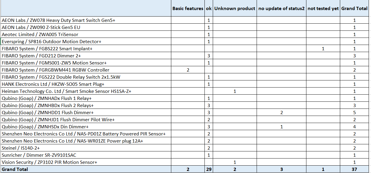

Some results of the testing, almost finish for the first part: basic testing: on/off, get: temp, lux, movement, Watt, kWh
Screenshot 2021-08-29 184800.png (57.61 KiB) Viewed 2141 times
21 different products, 17 with OKs
The issues:
1/FGRGBWM441 RGBW Controller: see above, not implemented totally
2/ Unknown product: wakeup issue?
3/ No update status: see above (on switch on/off the switch in the wall, the status in dz is not updated. Things to do on the network?
4/ No kWh in dz for all devices, Watt ok
5/ Perf issue with the log GUI for kWh
Next steps, solve the issues ; see the stability on a long period
For the stability: better than with OZW for the moment, because I did a lot off things w/o any outage, or freeze of the server (with OZW, I would have to restart dz several times!)
That's a very good start!

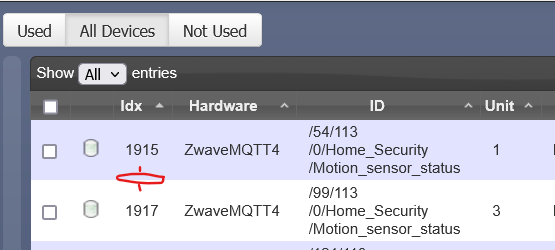

I think, I removed a device by mistake because I have a gap in the #
Screenshot 2021-08-30 075253.png (20.3 KiB) Viewed 2115 times
Is there any way to get it again?
Re: zwavejs2mqtt
Posted: Monday 30 August 2021 9:37
by heggink
Any device that gets reported (through a mqtt device) will ALWAYS be recreated by the plugin. The moment it sees a message for a supported device type/attribute, it will create a device for it if that device is missing from domoticz.

Varazir wrote: Sunday 29 August 2021 17:28
Hi @varazir, in order to understand what's going on, can you:
- create an issue on github
- switch on debugging and post the log in the ticket?
That way, I know what messages are being sent and find a fix.
