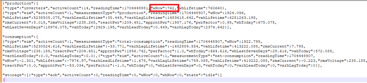

I have some doubts about the counter of device "Enphase kWh Production" based on the native Enphase hardware application.
Where does it get it's data from? Is it gathered from "http://envoy/production.json" ?
Which counter is used?
Below my Enphase devices.
I own 14 solarpanels, for the example I use both Enphase hardware applications (Native and Python Plugin).
I have already merged the solarpanels to the Native Enphase hardware application (so I only have 1 set of 14 solarpanals which receive their data from the Native Enphase hardware). I still though have the 2 counters.
The device named "Enphase kWh Production" (which is a counter of type general) is from the Native Enphase hardware application.
The device named "Enphase Envoy - Total" (which is a counter of type P1) is from the old Python Plugin hardware application. In the screenshot below a snapshot which is taken at the same time (10:59:42 hour).
Here can be seen that the old Python Plugin shows the same wNow (762Watt) as the Enphase Envoy Metered-S from its actuals (production.json).
When I add up the counters of the individual panels I also have 762Watt.
Where does the 1099Watts comes from within the Native Enphase hardware application?

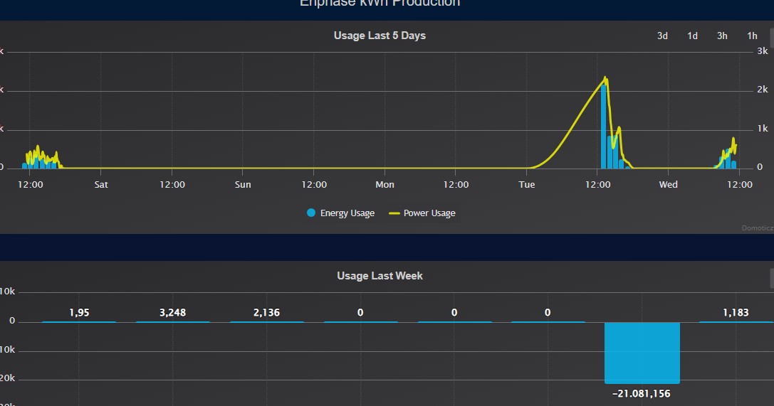

3 days ago the Envoy stopped publishing data to Domoticz. In log indeed the above mentioned Invalid data received! (no session_id) message. After logging in manualy to Envoy I was asked to generate a code. According to the Domoticz wiki I entered this code in de Domoticz user variable and after some minutes Domoticz started to report actual data again.
But.... it started with a negative value, see the sceenshot attached. In the data dump from Domoticz is no negative number, just to me logical higher values because envoy couldnt publish it data for a few days. See attached xls.
My question is how to " normalize" the data as it has impact on all graphs.

Good question @HansSch....
I saw this negative value also, thats the reason why I set the data timeout to 5 minutes to prevent this.
When restarting the hardware there is no need for a new code, it just works with the old code.

To get rid of the negative value from the chart:-HansSch wrote: Sunday 03 March 2024 17:35 Thanks @Xavier82. The restart after 5 minute option did not solve my issue. Thats why I renewed the key.
Still the question how to normalize the data. Enyone?
Hold down the shift key and click on the rogue entry on the chart, a pop-up should appear asking if you want to delete this entry.
Click OK, the entry should disappear from the chart. It won't correct any missing data that's caused it to appear, but at least it won't be there.
I had to do this after Enphase upgraded my Envoy-S-Metered from 4.10.35 to 8.2.4264. In the Domoticz hardware page I had to change the Envoy from port 80 to 443, I also put my Enphase website login credentials here after the initial token ran out (more on that later). In More Options -> User Variables there were two blank EnphaseToken_ entries, I web browsed to my inverter, from there followed the link to get the token, then pasted this into both blank entries.
At least I'm not stuck on build 15369 any more (this appeared to be the last to support data from 4.1.0.35).
Tokens don't seem to last very long, at least under V8; my first one only lasted about 24 hours, the second one has now expired (I just copied it from Domoticz back to the Envoy login page and it rejected it) but presumably Domoticz is now using the username/password entry instead, as the Envoy also gives the option to use Enphase credentials and Domoticz is still getting data from it.
If you're on a regularly restarted or regularly updated Domoticz build it'd be worth checking after each restart/update that it's still getting fresh data from the Envoy. If the devices on the Utility screen look like they've stopped getting data while the rest carry on, you might need to re-key or try giving it your Enphase login.
