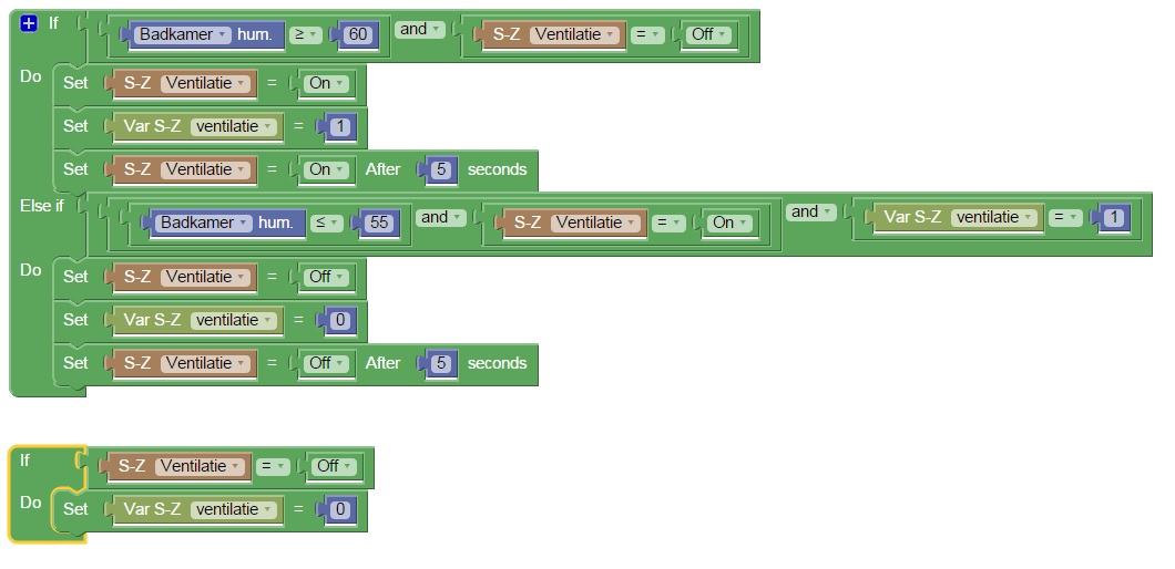

- Posts: 27
- Joined: Tuesday 28 October 2014 22:26
Re: Blockly examples
I have the follow blocky to control the humidity in the batroom
i have make the variable in the blocky so i can always overule by the manual switch
when the receiver from the ventilator miss the signal domoticz send it 5 seconds later againi have make the variable in the blocky so i can always overule by the manual switch
- Posts: 890
- Joined: Tuesday 30 September 2014 8:49
Looks good
Is the sensor updating fast enough? So you don't have your shower steaming for 5 minutes until the fan turns on?

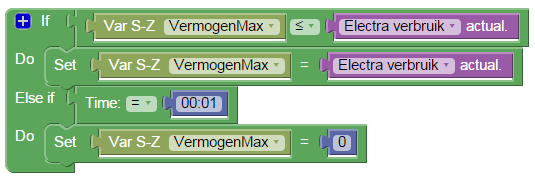

- Posts: 39
- Joined: Thursday 09 April 2015 20:57
- Domoticz version: 3.9317
Why is this not working?
i want to detect MaxValue of Usage (yes i know, i can see 24h log), but i want it in a variable.
So i made an UserVariable "VermogenMax" integer. I i'm checking if VermogenMax is smaller then the usage, if so, then save the actual value in VermogenMax. But the value stay's 0.
i tried to use a dummy device, type Usage, is also not working
Another question, how can i add VermogenMax (uservariable) to a roomplan? In order to show the value on frontpage.html.
- MaxDetectie.png (16.26 KiB) Viewed 8974 times

Sorry, didn't see your post.thecosmicgate wrote:DoneThinkPad wrote:A 'SomeoneHome' switch is easier, i also use it that way: http://www.domoticz.com/forum/viewtopic ... 521#p27521
But could you maybe explain a little bit about : variable that you use in the Switch on lights when we are home, and it is getting dark and Turn on lights when we arrive home and it is dark outside blocky you use .
I tried the wiki but don't understand exactely what this variable do and mean .
The var is so that when you turn the lights off, they don't turn on directly again (because the conditions are then all valid again). I reset the var at 00:01 or so i thought.
But i don't use that Blockly anymore, i now use the ABST-604 dusk/dawn sensor together with this script.
