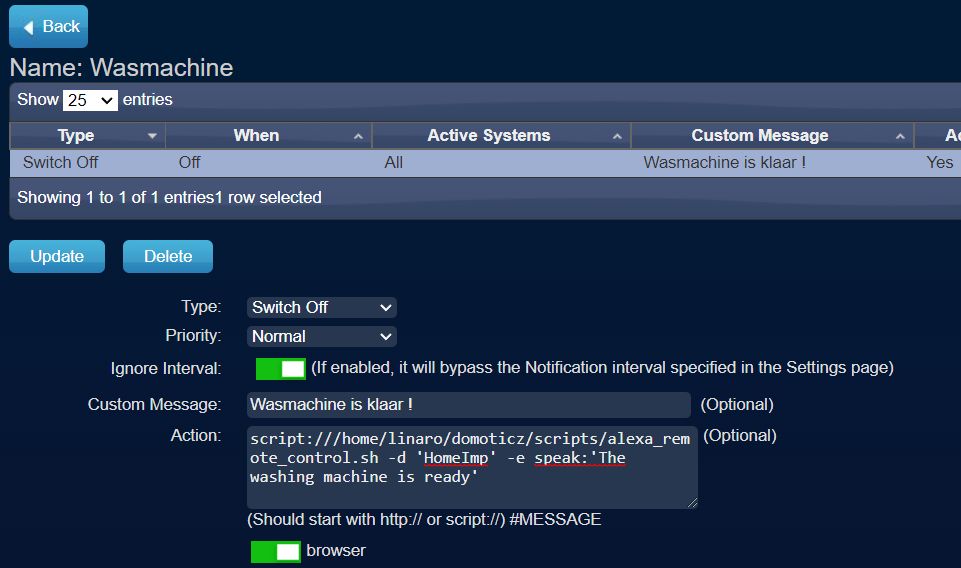

In beta 14040 I added the possibility to add a custom http/script action for each notification.
Using the script from:
https://blog.loetzimmer.de/2021/09/alex ... cript.html
With this you can set a custom message in your own language that is being send to (for example) PushOver and let your english speaking alexa speak something complete different
Hope it can benefit someone here

I'm not a master of pi, but with a proper tutorial I could replicate this function for myself. I have a zigbee socket with consumption monitoring, and theoretically I would like Alexa to notify me when the washing machine has finished the washing program. is there a whole tutorial somewhere so I can replicate this function?
thx
