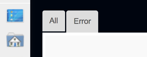

Don't know if mentioned by someone else.. the logging section is missing the status tab? Or did i missed a step at installing the theme?
Controloptions for squeezebox is a problem too. However, my compliments for this great theme.
blauwebuis
- Posts: 331
- Joined: Wednesday 21 December 2016 9:11
- Domoticz version: current
Re: Aurora theme
@zynexiz - yes, you have to click the reset button when you upgrade the theme. It even shows you a pop-up after you upgrade. It removes the old user variables as well as the local storage.
@ednl - You probably have the medium-privacy feature enabled. It hides the status tab. The full privacy option only lets the error tab remain.

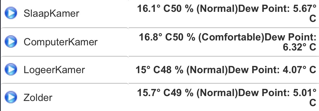

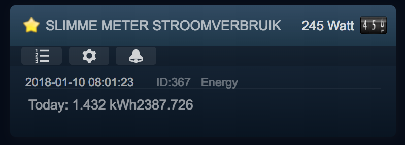

ednl
- Posts: 16
- Joined: Thursday 25 May 2017 13:29
- Domoticz version: 3.8875
Re: Aurora theme
@blauwebuis: thank you. That solved the issue with the logging.
anyone any idea about the logitech/squeezebox issue?
It works fine on Safari, It only works on Firefox when mouseover the playeroption. It doesn't work on Chrome.
unfortunately i'm working on Chrome
A few other things i noticed:
Missing a space after the kWh and a space after the first Celcius.

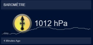

new issue with my barometer picture: it never shows since I install the last version from Github. I have done some digging, and I see that almost every time, the 'itemData.ForecastStr' value is 'undefined'. But when I load the json directy at 'http://myaddress:8080/json.htm?type=dev ... d=mydevice', I have never that 'undefined' value in the "ForecastStr' field.
Do you know what is causing that?
