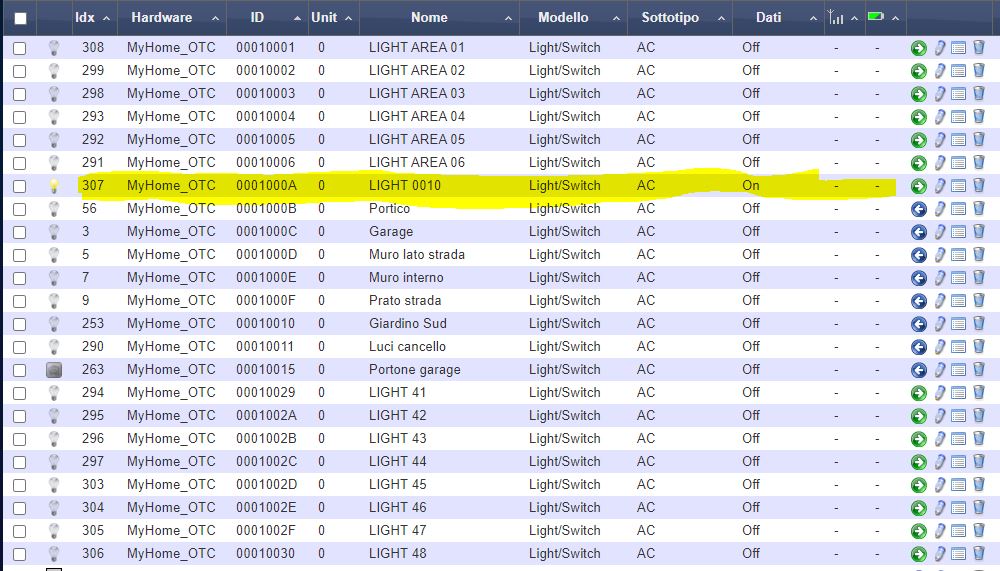

fmal
- Posts: 38
- Joined: Thursday 16 February 2017 14:08
- Location: Italy
Help identifying unknown device
I have an unknown device not used but always ON in my devices list. It's ID 1000A named LIGHT 0010.
Here are all the light devices, please could you help me addressing how to discover what is that? If I delete unused devices it reappears after a while.
Thank you!!!!
Thank you!!!!
